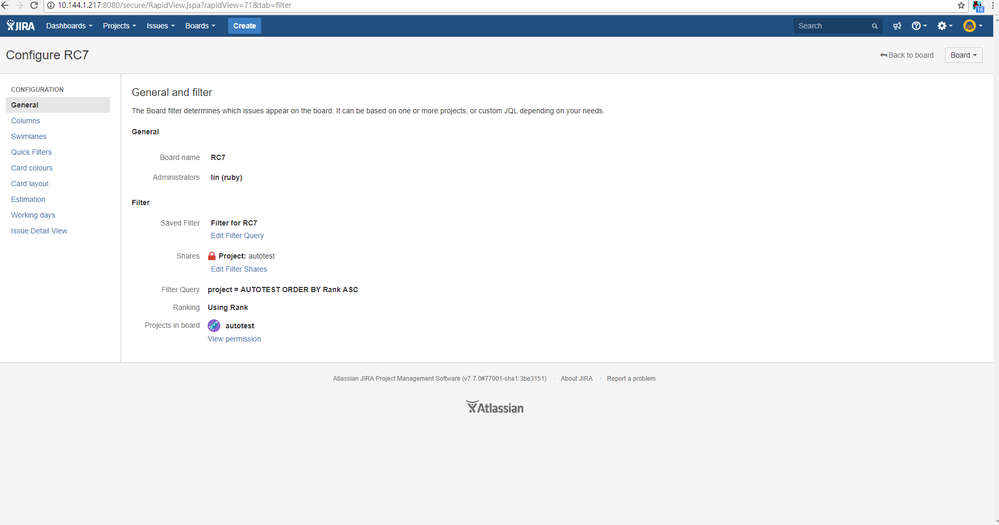

I assume your board is not configured the same way as the other board right? Does your board filter specifically look for issues with no resolution? Could you mabye share your board configuration here? Best, Max

I assume this is the config you asked for. Is this page, right?
Max Foerster - K15t
July 29, 2018
Hi Ruby,
everything on the "General" tab is important right now (Board filter). Could you please attach that information?

Ruby Lin
July 30, 2018
Hi Max,
I think this is it
Thank you
Max Foerster - K15t
July 30, 2018
Hi Ruby,
I can't see anything obviously wrong here. So you see all issues in the other columns but not in the Done column? And your not using any quickfilter by accident? Another screenshot of your "active sprints" view of that scrum board would be interesting as well.

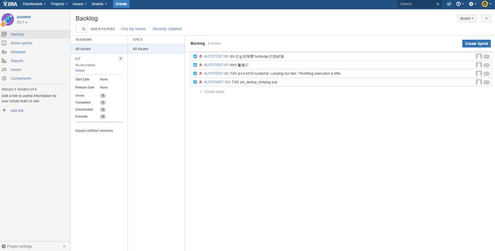

Ruby Lin
August 1, 2018
jira autotest.pngHi Max,
I don't know if it is by default that resolved issues are supposed to be hidden. so I can only see them while searching them.
Thank you
Max Foerster - K15t
August 1, 2018
Hi Ruby,
okay now it make's sense. I thought you weren't seeing the issues on the scrum board (="active sprints" in the sidebar). Right now you're looking at the backlog. And issues from the last column of the board (being in any status that is mapped to that column, so for example "Done") are never displayed in the backlog! If you want to see all issues, just head to the "Issues" menu entry in the sidebar and there set your filter accordingly.
Best, Max
