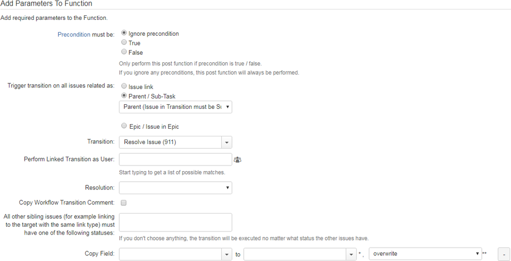

siva
September 14, 2018
we are using BOB SWIFT CONFIGURATION and JSU,
but as i check the configuration , its confusing,
if i need to transition a second subtask to resolved if the 3rd sub task is resolved.
can you help me with the fields to choose
issue transition.PNGose ( please check the screenshot)
Gezim Shehu [Communardo]
September 14, 2018
I'm not so familiar with BobSwift, however the link relation between two subtasks does not exits.
In theory they are not linked at all with each other. Parent/Subtask relation exists only 1to1 (parent to/from subtask)
