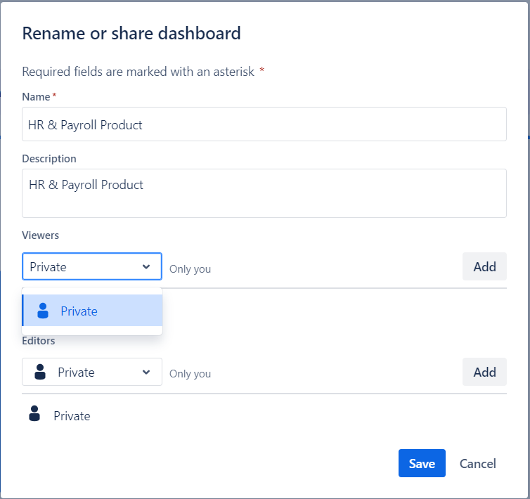

Team Project has option to share dashboard public or not. can I share dashboard with team while Team Project is created instead Company managed project

this is JIRA Dashboard of team managed project. I am not able to share filter as public and same case for JIRA dashboard. screen shot already attached. still you want to know something please let me know

Hi @Tankem Williams , Thanks for your quick response, I have changed the project setting from limited to open, still I am not able to share dashboard. can you please share specific link where I can get specific information

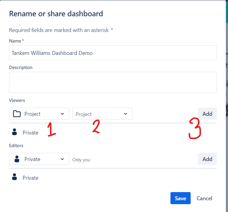

OK, I see what You mean.
As an Admin user you should see the following options to select from
Project
Group
My Organization
User
Private
If you cant, Please make sure you are the site admin or have enough permission to Create, configure and share dashboards.
https://confluence.atlassian.com/jirakb/only-private-option-available-while-sharing-viewer-permission-for-dashboards-and-filters-1235858985.html
When you have your permission issues resolved follow this instruction. On the viewer
1) Select Project ,
2) Search the Team managed project by name or key and select
3) Click Add , then save.
With this done, any team member with access to that teams project should be able to see the dashboard.
