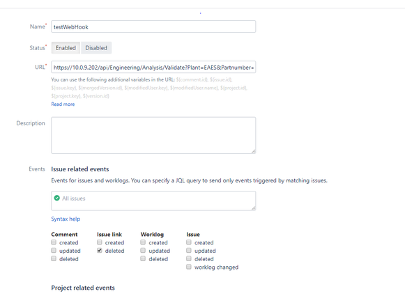

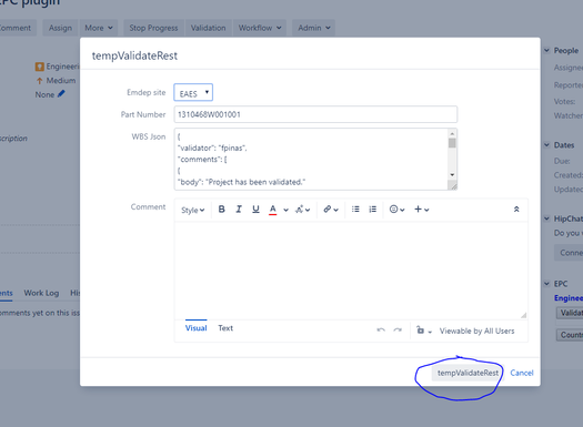

hi,, im new to jira  and i want to call above api with parameter Plant and Partnumber on transition  using post function .
Basically what i want is when i click on tempvalidateRest transition ,Api should call and according to  Plant and Partnumber values or status should update in other application ..
for this i hvae created webhook  and call it on post function .. but the values are not updating ..plz help me with this image.png

Hi @Sneha Gole
welcome to Atlassian Community!
Unfortunately, it is not possible to use your own variables (based on custom fields' values in issue) in webhook's url.
But I can image another approach could work for you.
Do you have Jira server or cloud?
If you have Jira server, I would recommend you to use ScriptRunner add-on and create post function with groovy script, which will take the values from the issue and use them to create url and body of the request.
