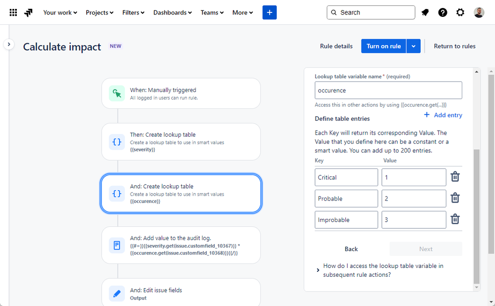

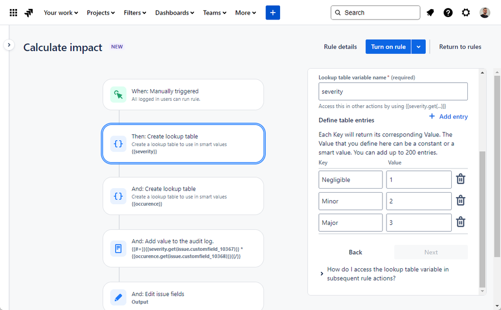

One way you could do this is by using Lookup table actions for 'mapping' select list options with specific (number) values.
For example, create two lookup tables for each select list field (one for Severity and one for Occurrence):

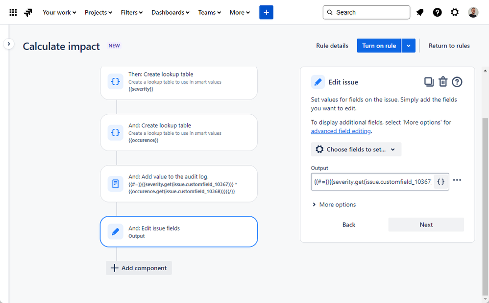

And then, assuming 'output' field is a number type field, you can use automation math expressions to calculate desired value:
In this example (as stated in your question), I've simply multiplied Severity * Occurrence values by using the following expression:
{{#=}}{{severity.get(issue.customfield_10367)}} * {{occurence.get(issue.customfield_10368)}}{{/}}
Of course, you can name those Lookup tables as you wish, and you need to use appropriate custom field IDs for Severity and Occurrence field that you're using.

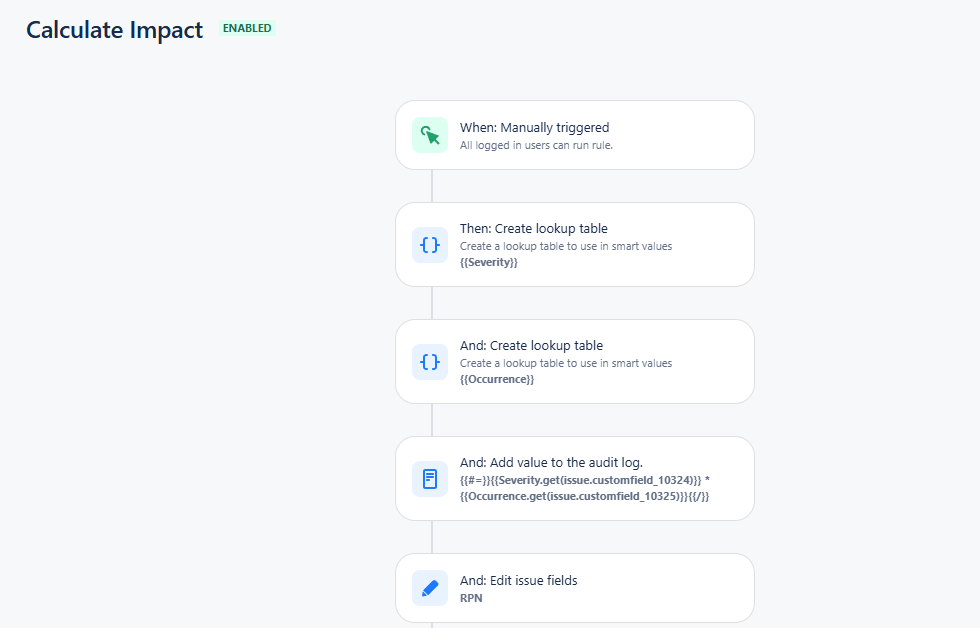

@thumuluru_shreya can you share some screenshots of automation rule and actions you're using (together with smart values and expressions within the rule)?
Additionally, I would suggest using Log action to check out smart values, calculations, outputs and any other values you can get within the automation rule to debug rules which you're testing.
thumuluru_shreya
January 5, 2025

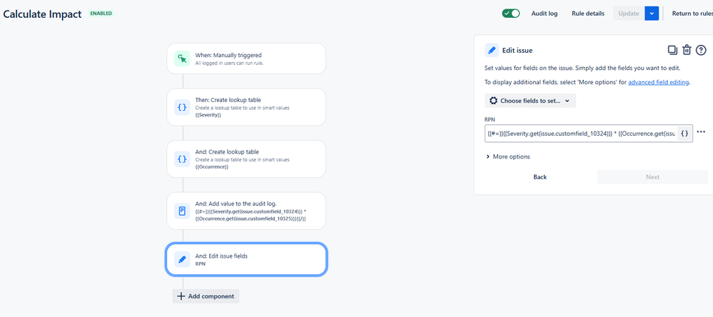

@Tomislav Tobijas , Could you please check and let me know
Tomislav Tobijas
January 5, 2025
@thumuluru_shreya can you confirm those are correct IDs for severity and occurrence custom fields? Also, as you stated, these fields are single select custom fields?
👉 I would suggest creating additional log actions for both {{issue.customfield_10324}} and {{issue.customfield_10325}} to see if you're getting correct values there.

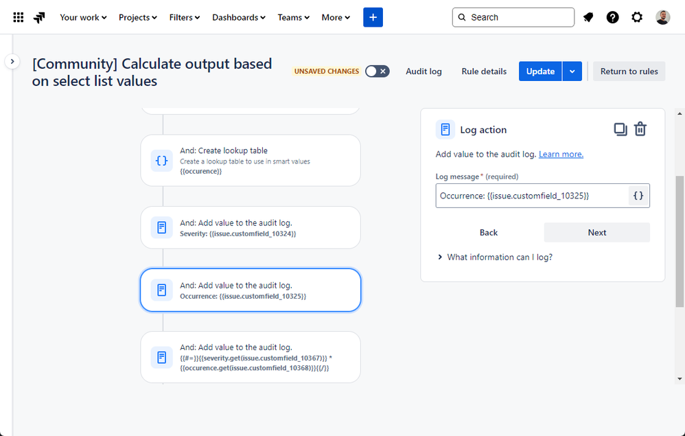

As for logging values for custom fields, I was thinking of adding two Log actions.
  1. Add Log action for Severity and Occurrence fields.2025-01-05 18-51-40.png

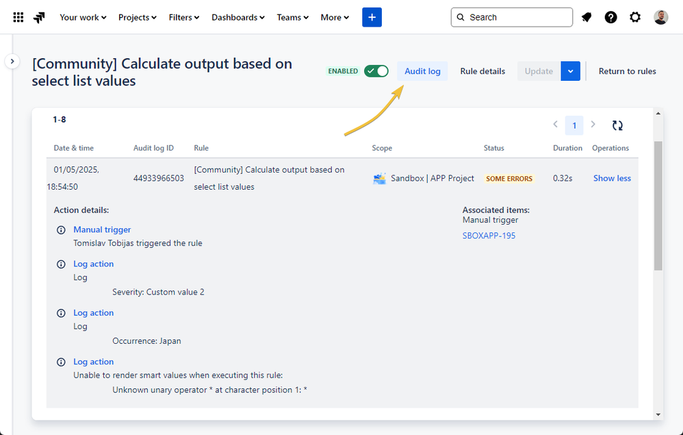

  2. Run the rule on one issue that has Severity and Occurrence field values.
  3. Navigate to the rule Audit log (see screenshot below) and expand the last execution log. There, you should be able to see what your rule is fetching within those Log actions.2025-01-05 18-56-09.png
