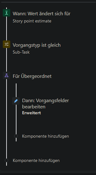

We have a global automation in two projects. The automation should simply sum up the story points of the subtasks of a story. In one board the sum up works as expected, in another board the same rule doesn't work. In the audit protocol Jira says "condition not passed", so the subtask isn't recognized as a subtask and therefore the automation stops. Is this a bug or how can we solve the problem?
The automation in the first step is checking if the changed value is a story point, then it checks if the transaction type is a subtask, if yes the it changes the value of the parent.

In the not working board the issue type is a Sub-Task and the automation is checking for a Sub-Task, so I can see no problems here.
In the working board the issue type is also named Sub-Task.
Because its a global rule the same issue type is being checked intrinsically.
Here is the automation scheme
The code of the rule is

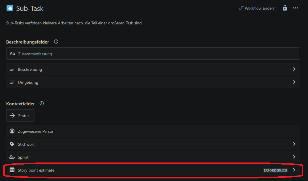

Is the estimation feature enabled on the 2nd project? And is the story point estimate field placed on the subtask issue type?
enrico
April 3, 2023

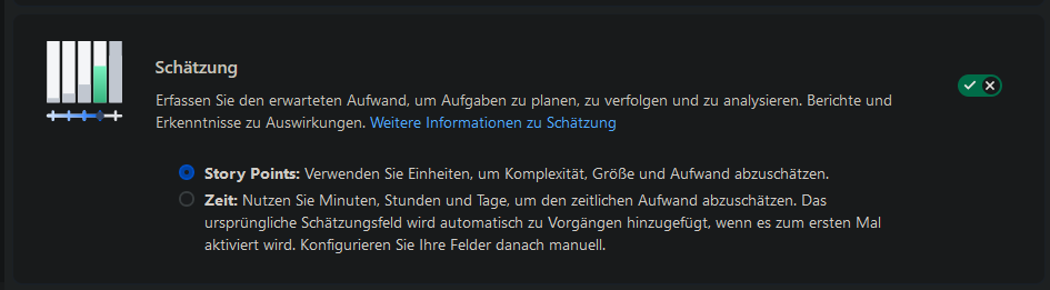

The Sub-Task does have the story point estimate field
and the estimation feature is enabled and set tostory points:

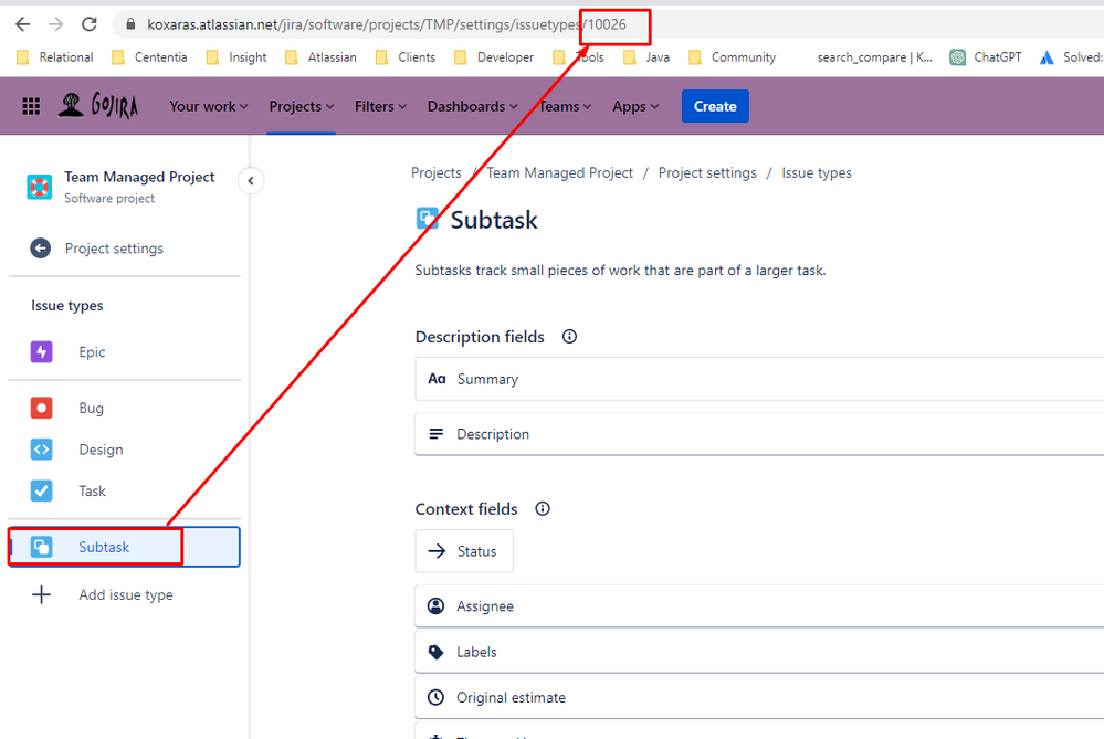

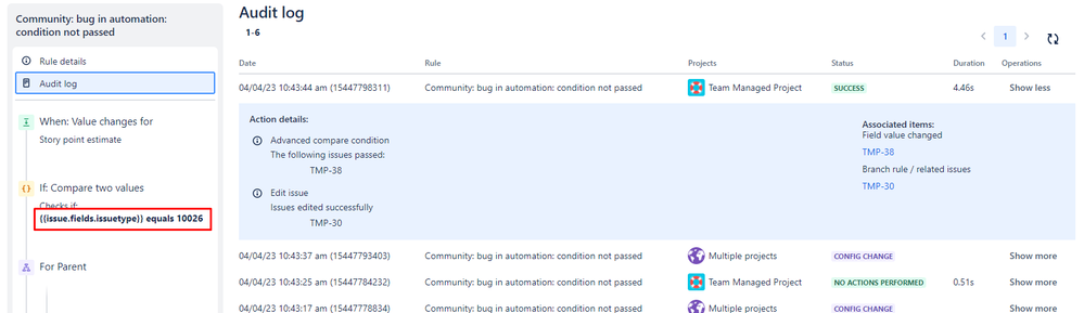

@enrico I think I found the problem. You should edit your rule's condition and you should place a smart value to compare against your issue type's id. E.g:
You should be able to locate the subtask's ID from the project settings:
Make sure that the id is the same for both projects. If not, then you have to include the second value as well.
enrico
April 4, 2023
You were right! I have two different IDs for the subtasks. Now I have included both IDs and now it works on both projects. Thanks for your help!
