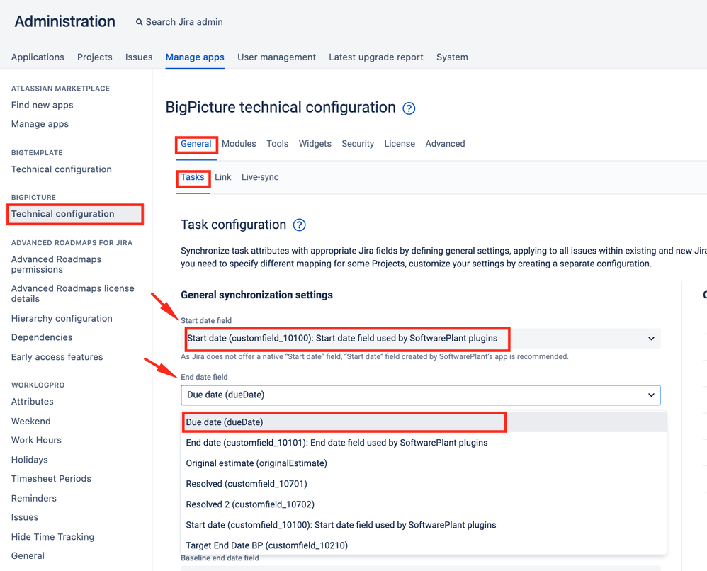

Regarding your second question, let me shed some light on the plugin logic behind it.
The start and end dates are required by the App to generate the task on the timeline. When task without date estimates are synchronized, the App will use the "Creation date" as both the start and end date mapped field values.
Please go to Jira Administration >> Manage Apps >> BigPicture/BigGantt Technical Configuration >> General >> Tasks and check what is the Start & End Date mapping. According to the information you gave, the configuration should be set as in my image below.
If you have more questions, just let me know.

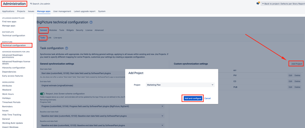

You can choose different mapping for, e.g., Start & End Date per Jira project by creating a separate configuration scheme—general settings are no longer apply to such Projects. See my image as a reference.
The list of projects with custom synchronization is displayed in the right column once the new synchronization is saved.
Let me know if something is unclear.
