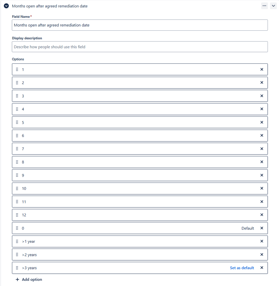

I have a custom field which is a drop-down list, that contains the values 0-36 & "> 3 years"

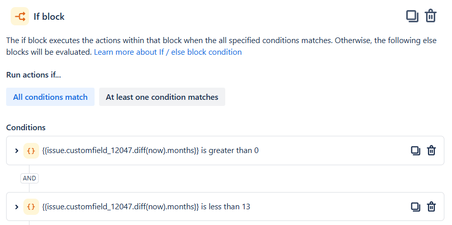

It's easy enough with the gui to have the if "{{issue.customfield_12047.diff(now).months}} is greater than 36" then set the field value to ">3 years"

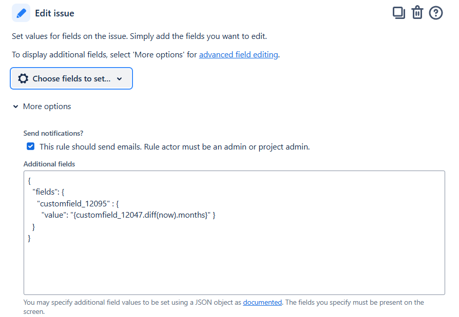

Less than 37 requires the JSON. This is as close as I've got but I'm obviously doing something fundamentally wrong.
{ "fields": { "customfield_12095": "customfield_12047.diff(now).months" } }
When run, the audit trail throws the error
Specify a valid 'id' or 'name' for Months open after agreed remediation date (customfield_12095))

...for the details on setting a Single-select Custom Field, you should use code like this:
"fields": {
"customfield_12095" : {
"value": "{customfield_12097.diff(now).months}" }

Thanks! That's let me move on from the id error to :
Specify a valid value for Months open after agreed remediation date (customfield_12095)
Again, any pointers appreciated.
The if rule looks ok. The other rules for >1, >2, >3 years work (I'm still fiddling and have changed the numbers from when I first posed)
The JSON seems right.
The dropdown as defined

Can you please provide screen images that show the entire rule and the details of the audit log for execution of the rule?

I believe your suggestion is missing some curly brackets around the smart value expression:
"fields": {
"value": "{{customfield_12097.diff(now).months}}" }

Thank you Bill and @Trudy Claspill, between the two of you I have it working.
Yes, the extra brackets on Trudy's suggestion were required.

Oops! Yes, of course a smart value needs double-curly-braces while the JSON syntax needs single curly braces.
