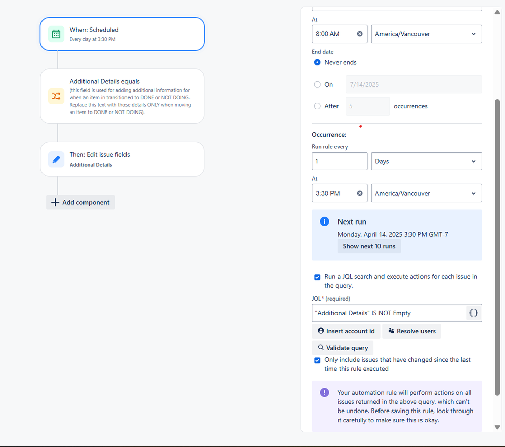

Here is the automation. There is a query that definitely succeeds in finding the relevant issues (I checked) but the automation just never actually does anything. The exact same automation triggered manually works completely fine.
The audit log simply says NO ACTIONS PERFORMED and then if I click it, it says "scheduled".clear additional details.png

It may be that check box in your screenshot that says "Only include issues that have changed since the last time this rule executed"
If those issues haven't changed at all, even if they show up in your JQL, the automation won't run on them.

oh my goodness! that was one of the default settings and I never thought to uncheck it. Thank you so much!!! I am in the process of testing it now. That would explain why it worked every once in a while but was not consistent.

šŸ¤”that change made it run on one issue but then every subsequent running did not perform any actions. The query brings up at least 100 items that match the query.

This is now working. Unchecking the box for only run on changed items largely fixed it. If the query returns a large number of results, it only seems to run on x number and then I just re-run it. Thanks Everyone!
