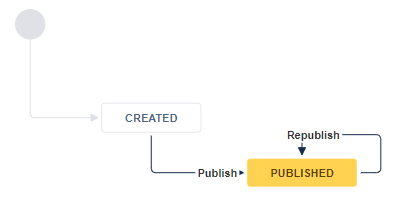

How can I trigger automation rule on loop workflow transition ('From status' and 'To status' are the same)?
Issue transitioned trigger doesn't work.
My workflow looks like this:

Martin Kovalcik
November 15, 2022
I hacked it by firing 'fake' Issue Created event (Publish and Republish transitions post functions).
The automation rule is triggered by Issue created trigger followed by condition checking if the Status field equals the value Published.

Martin Kovalcik
November 15, 2022
Both transitions fire an Issue Published event. It's my custom event I've added.
I'm trying to do my own notification solution using automation, because Jira built-in notification doesn't work for me. But I have troubles to trigger my rule with the Republish transition.

Martin Kovalcik
November 15, 2022
I don't want the rule to be triggered every time when the issue is updated. Just when it is published or republished.
Mikael Sandberg
November 15, 2022
In that case, the closest you can get to only trigger on that specific transition is to use the Multiple issue events. Yes, it will trigger on every transition, but that is as close as you can get. I did check and I didn't find a suggestion to have a trigger on the actual transition instead of the status.
