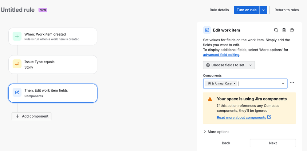

AnthonioD
March 17, 2026
That’s helpful Screenshot 2026-03-17 at 1.51.59 PM.pngthank you. I’ll share what I have so far (I’m a bit stuck). I’m not sure what the next step is to select the correct Component for this board’s backlog so that stories created in the backlog stay there and don’t disappear.
Bill Sheboy
March 17, 2026
That is a good start, and I have a couple of suggested improvements...
What is the filter for your board / backlog?  If you look at that filter, you will find which Component value to select in the rule.
Next, the Work Item Created trigger can have timing problems and so the rule can start so quickly some data may be missing.  The fix for that is to add the Re-fetch Work Item Data action immediately after the trigger.  This will slow the rule slightly, reloading the data before the steps proceed.
Putting those together, you would get:
  • trigger: Work Item Created
  • action: Re-fetch Work Item Data
  • field condition: Issue type equals Story
  • action: Edit Work Item
    • setting the Components to your value found in the filter
Please note well: this rule will replace the Components value.  If instead you want to add to any existing ones in the work item, the rule would use a JSON expression instead of selecting the field from the dropdown list.
