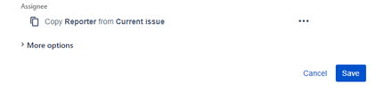

Hi Scott,
Do you have a rule built already using Automation For Jira?
If so, use the Edit Issue action and not Assign User action. Then Select Assignee and copy the value from another field.
I would just use Copy from Current Issue.
Then click on the words Current Issue and that will give you a popup where you can select the QA Resource field.

@John Funk I don't see how Edit Issue action would work as it does not let me update the assignee field to a value from another field on that same issue.

When I select Edit Issue, and Copy From Issue, the fields available are only:
No custom fields available.

@John Funk this is the screenshot, showing that we can't use Custom Fields:
Hey Joe - It's probably because the field is not available to either the project or the edit screen. Check the field Owner to see what is different about it because it is a custom field, too.
