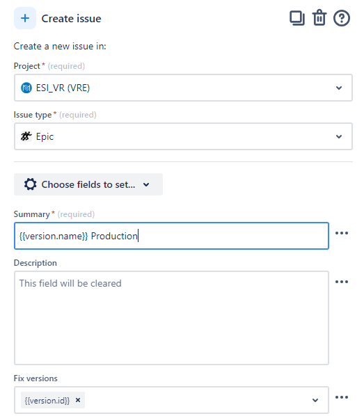

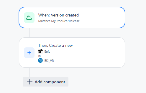

I thought the pictures would not add any valuable info therefore I didn't send that. However no problem to share them. Please find below the automation rule:
Note: I modified the pattern and this one seems to work pretty well for my need, so only my second problem remains (epic creation).
The details of the Epic creation is like
As you see it is a very simple rule for now (I'll complexify step by step). Just create an Epic in the given project - VRE (I tried "in same project but it didn't change anything) and just set the summary and the fix version.
I set {{version.id}} as you suggested but it didn't help. At least I don't know if it improves or not since the error message is of no help for me.

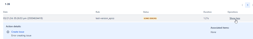

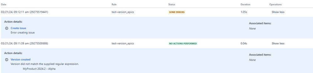

Here we see the first (below) trial were I gave a different name than Release to check if the naming pattern was working and it seems it is ok.
Then I made another trial with the right name (upper) and the rule passes to the next step which is Epic creation. But then "some error" happened.
I don't know if I can trigger some more debug information.

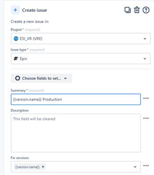

Bill Sheboy
March 21, 2024
Sorry for my mistake, as when I just tested an example rule, I found that the name must be used to set the fix version in the issue create: {{version.name}}
Please try that and let me know what you observe.
Also...Are you trying to create an issue in the same project where the version is created, or in a different project?  I tested in the same project, with a project-scope rule.
chm
March 21, 2024
Hi
I tried also with {{version.name}} but it doesn't change.

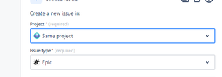

I tried using the "same project" option for the Epic creation but then I get a complain about it not being defined.
I would have preferred this generic option to deploy it as a global rule but I can handle it as local rule, not an issue.
Bill Sheboy
March 21, 2024
I just tested this scenario as a global-scope rule and it worked for me, with a specific project selected and "project from trigger" (which would automatically select the project for the version).

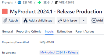

After running all the verifications above I started to believe I was doing the right thing (since it works for you) but I must have forgotten a basic thing. So I created a new rule which is "manual trigger --> create an Epic". No smart value, nothing fancy. As simple as that. This simple rule failed as well. Then I realized (how dumb I am and) that in our template, we have couple of mandatory fields at creation time. Once I added all those fields to the rule and set proper values, my simple rule worked.
I did the same changes to the initial rule which is triggered from version creation and I got my Epic issue created, with the correct title and the correct fix version.

Bill Sheboy
March 22, 2024
Well done diagnosing that!
That is a curious, and unhelpful error in the log for the required field.  When others have encountered that scenario a different error can appear for this in the audit log.  My hypothesis is this error depends upon the type of field which was required.

my requirement is when a version is created, if its name matches the pattern, then couple of EPICS must be created. The Epics should get the version name in their summary, plus some addition to give the topic of the Epic. The fixversion should also be set with the version name.
Yes as of today our process is to have "- Release" in it as we use the releases also for intermediate milestones (if Atlassian release the milestones in Advance Roadmap we may change our process but they didn't comment on the request lately).
I think I found a working pattern with "ProductName.*Release".
