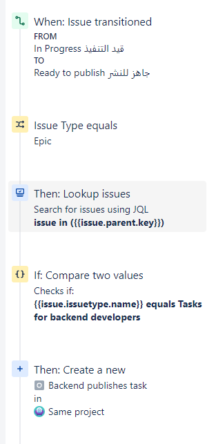

Hi hope everyone is doing well
 I want to create a rule where I want to create a task when the epic status is change but the condition is there must be a specific task present inside the epic so it can create the new task otherwise it cant i.e
If the epic transit from in progress to ready to Pulish then if epic have the task name tasks for backend developers then it will create a new task backend publish task

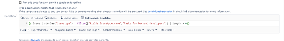

Umar Maroof
March 7, 2023
@David Fischer I copy the same condition that you give me still its not workingScreenshot (23).png

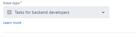

Please note that the issue type name is case-sensitive. Can you check the exact issue type name of the issue that should be under the Epic being transitioned for the new issue to be created?
Umar Maroof
March 7, 2023
Umar Maroof
March 7, 2023
@David Fischer this is the name of the tasks if this task is present under epic and epic transit to one status to another status the new issue should create...if I remove the condition its creating the issue but with condition nothing happening

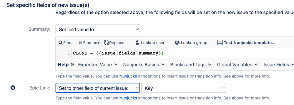

@David Fischer 1 More thing like I want the newly created issue will be the child of that epic so when I set the field epic link as copy of current issue its not copying the epic link.
David Fischer
March 9, 2023
You need to set the Epic Link field to "Set to other field of current issue:" and select the "Key" field:

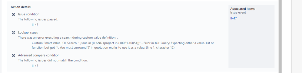

Fabian Lim
March 5, 2023
Hi @Umar Maroof
Can you share a screenshot of your audit log to see what the error is?
Regards
Umar Maroof
March 6, 2023
Fabian Lim
March 6, 2023
Hi @Umar Maroof
The rule doesn't work because you are looking for a parent for the epic which does not exist.  So that's why is empty.
You can try creating a branch to go under the tickets in the epic (https://support.atlassian.com/cloud-automation/docs/what-is-rule-branching/)
Then use a JQL condition to check whether the specific ticket type and summary exists, if it does, then you can create a new variable action that tells you that the ticket exists.
Branch out of the rule and then transition the epic and create a new task and link it.
If you have the budget, I would spend the money on JMWE or JSU which have workflow functions pre-built for this. This action for Jira Automation becomes very messy.
