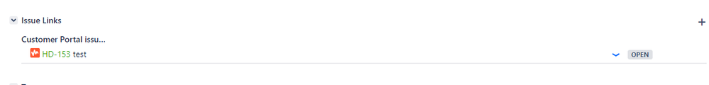

I need to check if the current issue has issue-link of type "Customer Portal issue"
then
if: the issue status is "2"
then change issue link of type "Customer Portal issue" status to "5"
will you be able to assist?

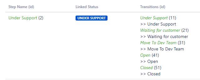

1. at "action id" if i want "under support" should i put 2 or 11? i tried both and it didnt changed.
2. customerIssues.each run on all issues link?
1. you should use Transition id(3rd column), for Under Support --> 11
2. Yes, if there are more customer issues linked to it. it'll run for all of them which all linked to current issue
it will have only one link of type "Customer Portal issues" in each issue.

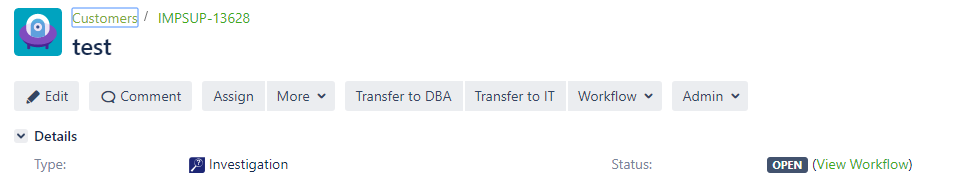

I made a rule: when i create an issue of type: IMPSUP
then the link of type "Customer Portal issues" who is connected to the issue, will be created.

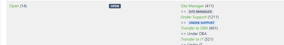

For the issue status, it has lot of different types, the first step is Open-> Site Manager
workflow schemes:

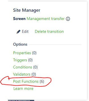

so i go to that flow and press "Post Functions"
I want to check if only the issue has:
the link type of Customer Portal issues and the issue (IMPSUP) change from Open to SIte Manager -> then link issue Customer Portal issues status will be changed from Open To Under Support.
Your code check if the link issue status changed... how do I make it check if the issue status changed?

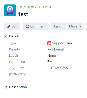

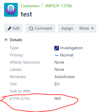

I`m trying to make a customFiledId(13600) named: lastUpdate, to be copied from issue to link("Customer Issue") at each Transition.
can't figure how to copy the value of the filed inside For loop

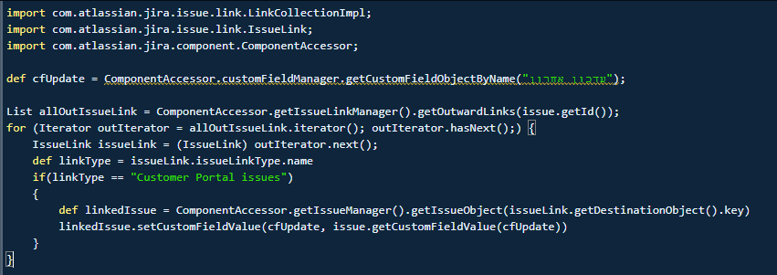

Ok,
I just need to get on each Transition - issue.customFiled.id(13600) and set it to:
issue.link("Customer Portal issues").customFiled.id(13600)
can you rewrite the logic?

import com.atlassian.jira.issue.link.LinkCollectionImpl;
import com.atlassian.jira.ComponentManager;
import com.atlassian.jira.issue.link.IssueLink;
import com.atlassian.jira.component.ComponentAccessor;
def cfUpdate = ComponentAccessor.customFieldManager.getCustomFieldObjectByName("Custom Field Name")
List allOutIssueLink = ComponentAccessor.getIssueLinkManager().getOutwardLinks(issue.getId());
for (Iterator outIterator = allOutIssueLink.iterator(); outIterator.hasNext();) {
IssueLink issueLink = (IssueLink) outIterator.next();
def linkType = issueLink.issueLinkType.name
if(linkType == "Customer Issue"){
def linkedIssue = ComponentAccessor.getIssueManager().getIssueObject(issueLink.getDestinationObject().key)
linkedIssue.setCustomFieldValue(cfUpdate, issue.getCustomFieldValue(cfUpdate))

Here is the spot

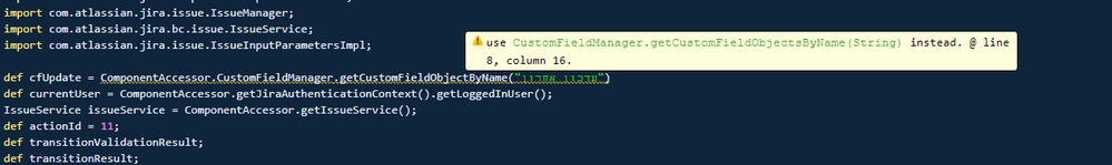

def cfUpdate = ComponentAccessor.customFieldManager.getCustomFieldObjectsByName("עדכון אחרון")
it's not getCustomFieldObjectsByName() "s" should be removed if not it'll throw list of custom fields but the method is for a field
it should be written as

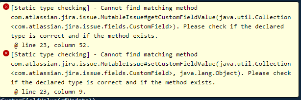

now it tells me to use getCustomFieldObjectsByName("עדכון אחרון")
I tried to use getCustomFieldObject(long) and to write the FieldID(13600) but it didnt work...
you can ignore this warning, or else you can switch to another method
def cfUpdate = ComponentAccessor.customFieldManager.getCustomFieldObjectById("customfield_13600")
@Leo the script was failed.
Its alerts that there is no such function:getCustomFieldObjectById()
this is how my issue look:
and the link "Customer Portal issues":
the Code is as you send me:
any suggestion?
