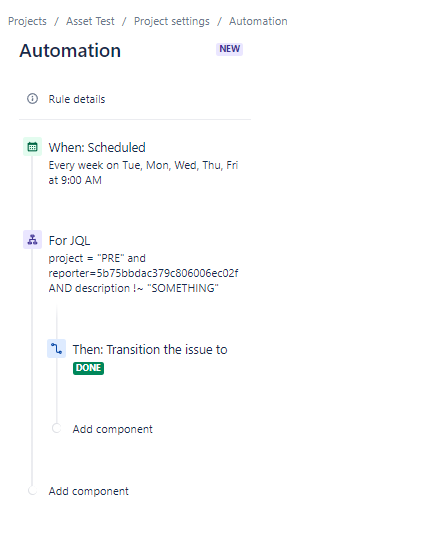

I would approach the solution with an automation like this
But as you say you do not have administrative rights it is worth checking with your administrators first to understand what rules are already defined at both global and project level.

Many Thanks Phil - I believe the automation does work because it processes the tickets anyway but it just doesn't shut them which is the part not working. I asked the project lead to provide me with the process so I can have a look at the condition and check if this is met at all.
Phill Fox
June 29, 2022
In which case you might need to add an additional action to set the resolution on the issue as well as transition it to the end status.
