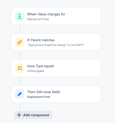

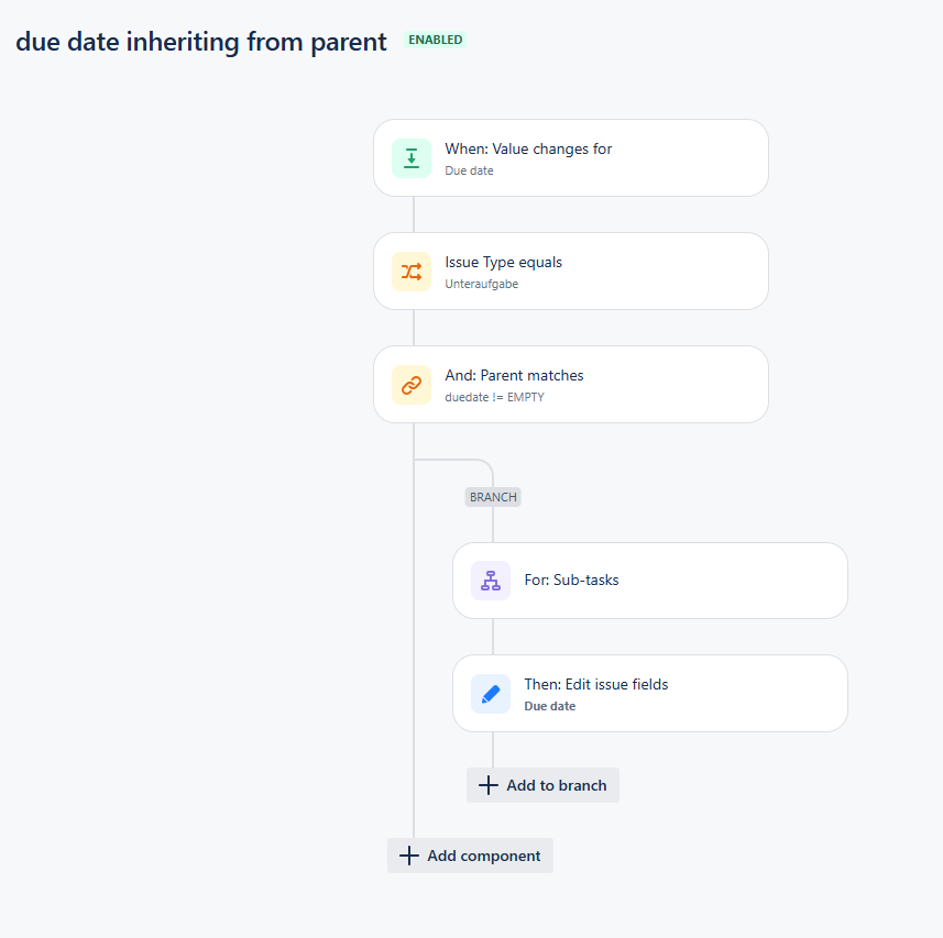

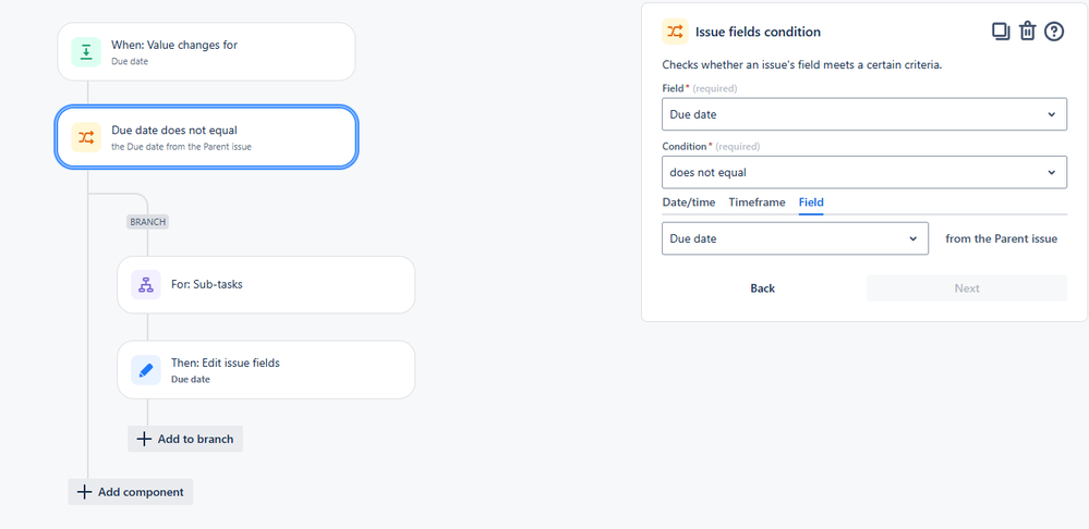

I´m new in automatic rules in Jira cloud and I tried to google for solution to my problem  but haven´t found it.
We want the sub-tasks to inherit a custom field "Deployment Prod" (it´s a date field). this field can be filled in in the parent at any time (no status or transition specified).
I tried several ways but none of them is working. please see attached my 3 attempts and assist me on setting it up. thanks a lot, Martina

Piet Pieters
July 16, 2024
Hey @Martina Hurtečáková ,
In all cases, your condition speaks of the parent issue. You assume that you would start the rule from the subtask itself. But the trigger here would be the parent, not the subtasks (as the change in the field happens on the parent.
Meaning -> If you change the duedate of the parent issue, start the rule with the parent and and then copy that date to all subtasks.
Your condition should be on the issue itself, not its parent.
It looks like your first screenshot is the closest attempt
  1. When the field of an issue is changed -> correct
  2. Check if the issue is the right issuetype -> not correct: unteraufgabe is the subtask I'm assuming? You are going to trigger this rule and allow it when you change a duedate on a subtasks, and then copy that field to its subtasks (which do not exist)
  3. Check if the field is not empty -> not correct: this needs to be on the issue itself, not the parent
  4. For subtasks: copy date field from issue -> I don't know how you configured that one, please provide a screenshot if the above does not work.

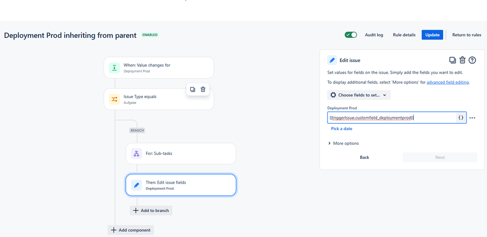

Martina Hurtečáková
August 1, 2024
Hello @Piet Pieters ,
thank you for trying to help me but I wasn´t successful in solution.
first of all I need the rule(s) to be created for another custom field called "Deployment Prod" (Type: Date time picker). and I changed the rule as follows:
Aufgabe= Task.

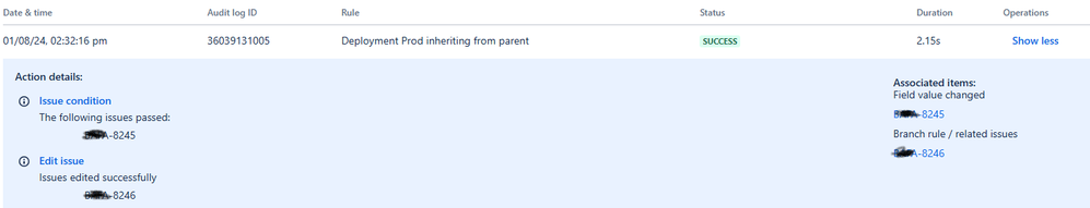

and Audit log shows success. however in the tickets it´s not performed.
  • Task is 8245
  • Sub-Task is 8246
I will be grateful for any kind of support, how the rule needs to be set up, to ensure that the "Deployment Prod" field in every sub-task is filled in based on its parent issue (Epic, Task, or Story), doesn´t matter if by creation or edition.
Thank you, Martina
Piet Pieters
August 2, 2024
please use the following format for your smartvalue:
{{triggerIssue.Deployment Prod}}
You need to use the actual name, OR the ID in the following format (you get the ID for the field when editting the actual custom field)
{{triggerIssue.customField_fieldId}}
The action is succesfull because you do add something to the field. only the smartvalue you are using doesn't exist so it returns an empty value.
Please let me know if that works.

Martina Hurtečáková
August 2, 2024
@Piet Pieters - yes it works! my smartvalue was wrong. thanks a lot
