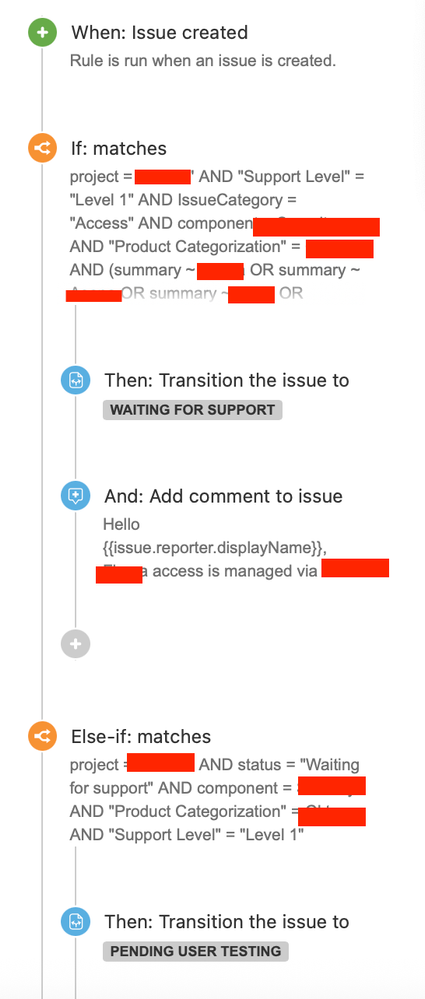

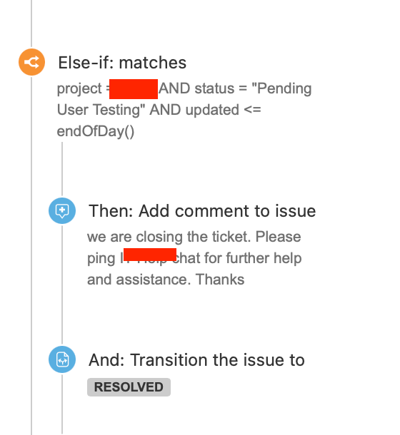

Hi @Stefan Stadler @Antonio Panea Pastor @Phill Fox
I have created below rule upto Step 4 works well and success after that no progress please suggest . Thanks
Automation Rule
Step 1 : When Issue Created
Step 2 : If: matches
JQL : project = "XX" AND "Support Level" = "Level 1" AND IssueCategory = "Access" AND component = ABC AND "Product Categorization" = BCD AND (summary ~ A OR summary ~ B OR summary ~ C OR summary ~ D OR summary ~ E ) ORDER BY summary DESC
Step 3 : Transition issue to : Waiting for support
Step 4 : Add Comment to issue XXXXXXXXX
Step 5 : Else-if : Matches
project = "XX" AND status = "Waiting for support" AND component = ABC AND "Product Categorization" = BCD AND "Support Level" = "Level 1"
Step 6 : Transition issue to : User Testing
Step 7 : Else-if : Matches
JQL : project = XX AND status = "User Testing" AND updated <= endOfDay()
Step 8 : Add Comment to issue : Closing the ticket
Step 9 : Transition issue - Resolved

I have created below rule upto Step 4 works well and success .....after that no progress please suggest . Thanks
Automation Rule
Stefan Stadler
June 24, 2025
Hi @Sampath
every automation rule has a logging mechanism that shows, which branch has been used. You say, that the works well up to step 4 (which means, the first comment is added to the issue).
Is this understanding correct?
If this understanding is correct, it also means that the if/else branch has been completed. It can always only be executed one of them, if any. The log can tell you, which branch has been used and without that logging, all we can do is guessing.
Can you share the rule as a screenshot and also post a screenshot of the logging for the automation?
Regards,
Stefan

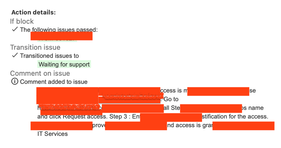

Sampath
June 24, 2025
Hi @Stefan Stadler
Yes First comment added to the issue, after that below audit log
The following issues did not match the condition
Error transitioning issuesScreenshot 2025-06-24 at 6.22.25 PM.pngScreenshot 2025-06-24 at 6.17.53 PM.png

Sampath
June 24, 2025
HI @Stefan Stadler
Audit Log : Status shows : Success upto step 4  after that transition not happened
Stefan Stadler
June 24, 2025
Hard to answer what is wrong when almost all text is hidden…
I can read the word „Access“ in the message. Could it be that the executing User does not have enough permissions?

Sampath
June 24, 2025
Hi @Stefan Stadler
Audit Logi : Error
ITSM-XXXXX (This field is required (customfield_XXXX))
Stefan Stadler
June 24, 2025
As you can see in the log, there is a mandatory field required for this transition. That appears to block the transition from happening. You have to add the Field in the configuration of this step.
