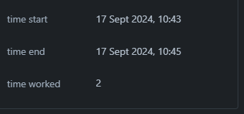

you can accomplish this by creating 2 automations and 3 customfields .
The customfield could have the names start time and end time and time worked.
For the first automation the trigger would be transitioning into in progress and then add edit issue as an action where you select the customfield start time and write into it the smart value {{now}}. Then give the automation a name and save it.
Then add the 2nd automation where the trigger transitioning from im progress and you can leave the nd option empty. Then ass action select edit issue again and choose your 2nd customfield end time and write into it {{now}}. Then you write into the field time worked: {{issue.customfield_xxxxx.diff(now).minutes}}. fill in the id of your start time field here you can acces the id by copying the number from the url when you view the customfield in the adminstration and press context and default value. this now should be set up and work.
Remember to add the 3 fields to your screen so theyre vissible and useable for your project.
Finished result should display it like this

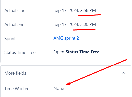

Azizbek Umaraliyev
September 17, 2024
@Henning Stoll Thank you for you answer, it is really useful, and I appreciate it.
There is one problem.
I can't seem to get that timeworked to show up ?

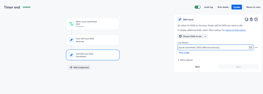

and the field looks like this:
Could it be because of the smartvalues ?  because I made sure to wait a few minutes
Henning Stoll
September 17, 2024
Hello @Azizbek Umaraliyev
what customfieldtype did you use for the field time worked ?
Henning Stoll
September 17, 2024
oh i see you used a dat field for this aswell, i can tell by the pick a date in your automation, this wont work since the date and time field can only hold date and time but we want it to hold a string( the reuslt of our calculation).. So the time worked should be a  text field. Just delete the current one create a new one with the same name and make it a text field and then change the id in the automation and redo the test.
