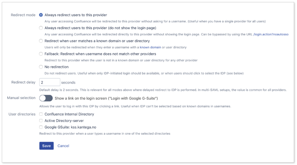

I work for Kantega SSO, and I have attached screenshots from our configuration pages where you can set Okta-login to only trigger for certain domains or user directories.
The fallback-redirect mode in the screenshot allow you to set a SAML idp as auth-fallback. You can also configure the redirect rules to redirect to traditional login as fallback.
