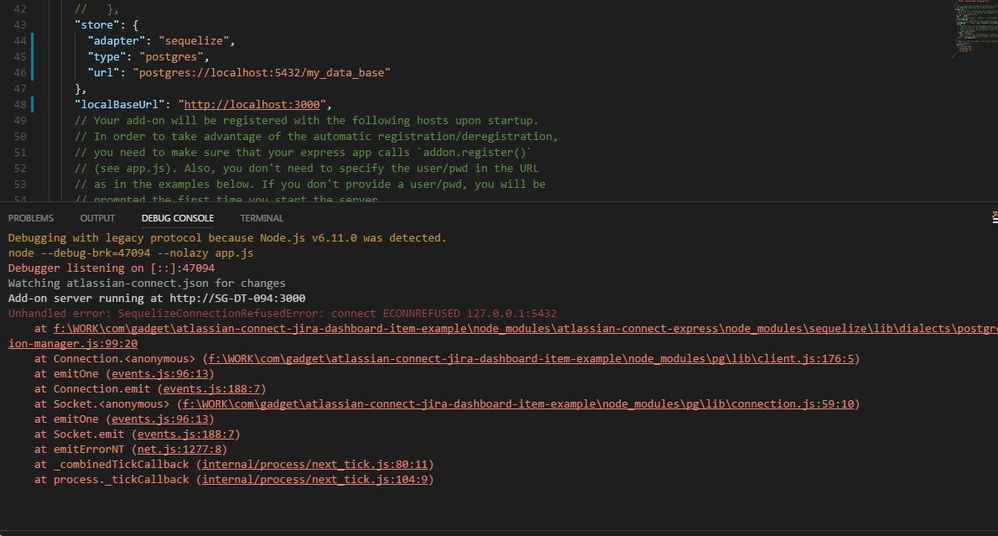

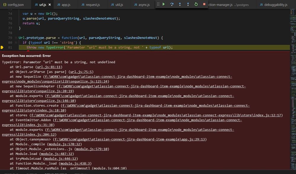

Yes, I have changed the adapter to "sequelize", type: sqlite3, database: store.db, then giving the error as "url should be defined"
Then changed the type: postgres
url: "postgres://localhost:8080/my_data_base", then gives the error as "Unhandled error: SequelizeConnectionRefusedError: connect ECONNREFUSED 127.0.0.1:5432"
Please find the attached pictures. As you can see in first pic, if there is a url, we get one type of error...
If there is no url, you can see the error in the next picture...
