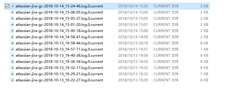

But I still can't use it. In the task manager I found that the service could not be started.
In the relevant log folder, I didn't find any useful information and no error message.
贤者TM
October 14, 2018
Snipaste_2018-10-14_15-30-41.pngJava HotSpot(TM) 64-Bit Server VM (25.181-b13) for windows-amd64 JRE (1.8.0_181-b13), built on Jul 7 2018 04:01:33 by "java_re" with MS VC++ 10.0 (VS2010)
Memory: 4k page, physical 25103064k(14024668k free), swap 26675928k(8611240k free)
CommandLine flags: -XX:GCLogFileSize=20971520 -XX:InitialHeapSize=268435456 -XX:MaxHeapSize=805306368 -XX:NumberOfGCLogFiles=5 -XX:-OmitStackTraceInFastThrow -XX:+PrintGC -XX:+PrintGCCause -XX:+PrintGCDateStamps -XX:+PrintGCDetails -XX:+PrintGCTimeStamps -XX:+UseCompressedClassPointers -XX:+UseCompressedOops -XX:+UseGCLogFileRotation -XX:-UseLargePagesIndividualAllocation -XX:+UseParallelGC
Heap
PSYoungGen total 76288K, used 10486K [0x00000000f0000000, 0x00000000f5500000, 0x0000000100000000)
eden space 65536K, 16% used [0x00000000f0000000,0x00000000f0a3d940,0x00000000f4000000)
from space 10752K, 0% used [0x00000000f4a80000,0x00000000f4a80000,0x00000000f5500000)
to space 10752K, 0% used [0x00000000f4000000,0x00000000f4000000,0x00000000f4a80000)
ParOldGen total 175104K, used 0K [0x00000000d0000000, 0x00000000dab00000, 0x00000000f0000000)
object space 175104K, 0% used [0x00000000d0000000,0x00000000d0000000,0x00000000dab00000)
Metaspace used 4776K, capacity 5100K, committed 5248K, reserved 1056768K
class space used 533K, capacity 604K, committed 640K, reserved 1048576K
