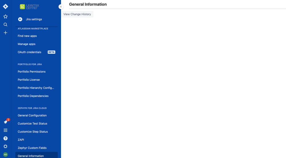

General Information displays empty screen with I'd say collapsed "View Change History" button :/
I'll reach out to zephyr support. Thank you
