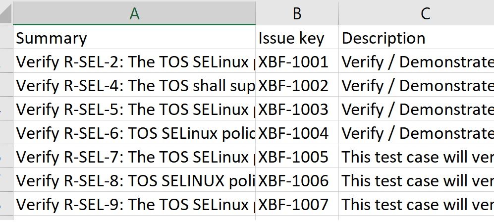

I exported all of the test cases with the missing Description from JIRA/Zephyr to a .csv files. I then deleted all columns except for Issue Key and Summary (I saw another post that said that those are required fields). I then added a column named  Description with the data I want to update for each test case. I then saved the .csv file as an .xlsx file.

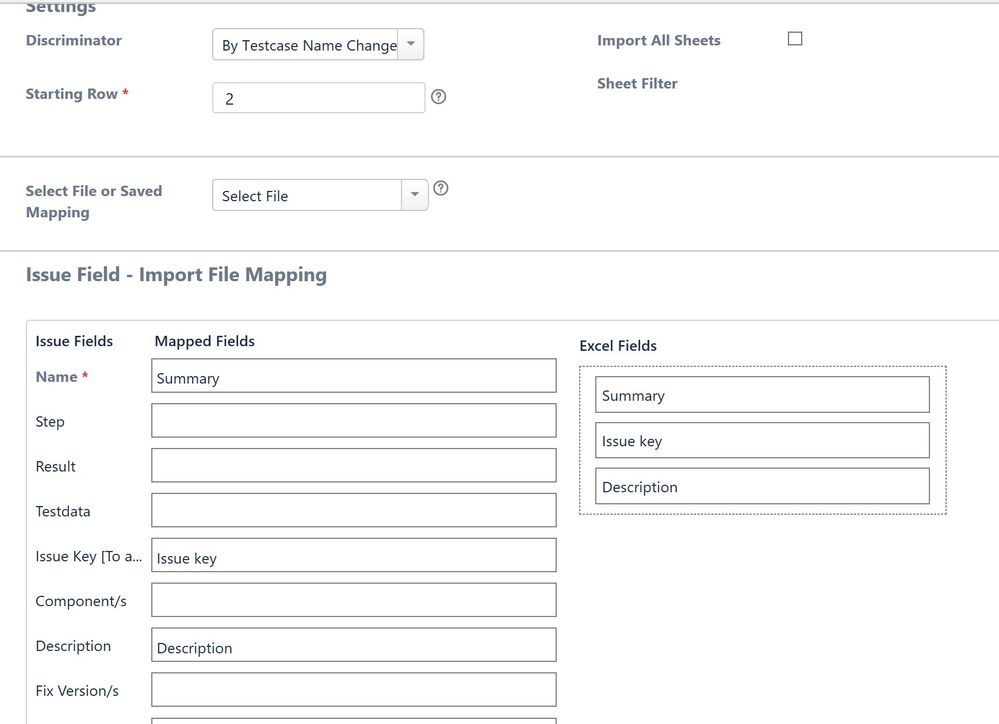

I've tried using the JIRA Importer to then import/update the existing test cases. I selected my Project, and Issue type "Test", my .xlsx file, clicked "Retrieve Mappings", and set my "Discriminator" to "By Test Case Name Change" (I've actually tried all options except "By Empty Row").
I then mapped as follows:
Name = Summary
Issue Key [To add steps] = Issue Key
Description = Description

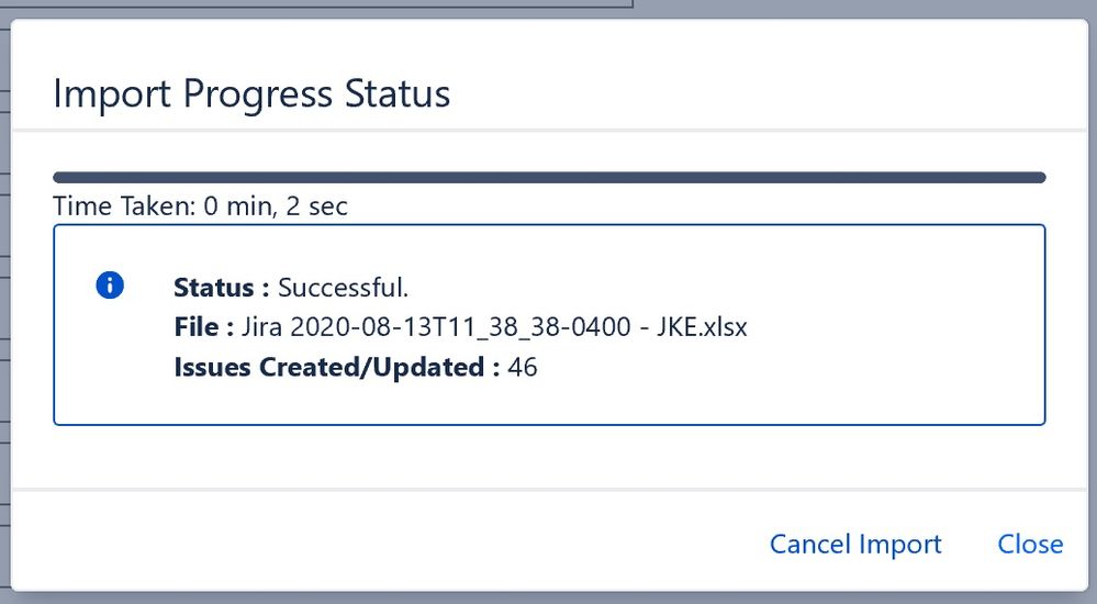

I click "Import", and the Importer tool tells me that it "Created/Updated xx test cases", however when I check the test cases they are not updated. Nor do I see new test cases created.
What am I doing wrong?

Hi Jordan,
  • Your mapping is correct, I feel description field is not added to the create issue screen, please recheck once and try again
Ref: https://zephyrdocs.atlassian.net/wiki/spaces/ZFJ0400/pages/422576142/Import
If you are still facing issue can you please raise support ticket, so that our team will check the issue
https://support.smartbear.com/message/?prod=zephyr
