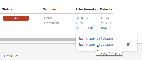

  6. Mouse over the attachment link to see any comments entered when the attachment was uploaded.
Mark Lapierre
June 8, 2018
These steps still don't allow me to see attachment comments. When I mouse over the attachment link I only see the attachment filename:
