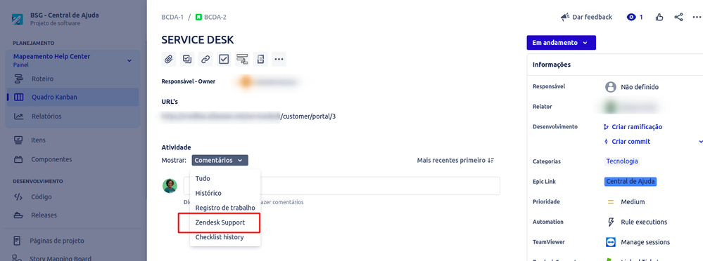

Is it possible to set the Zendesk Support Tab to be the default tab upon loading?

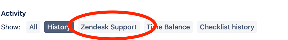

I swear I read through this support article about 12 times yesterday but I just noticed this line today:
I checked and reporter wasn't on the create issue screen for my project, so I added it (and made sure it was on all create issue screens in the screen scheme for that project).
Then I went to the app config page in Jira, to the project restrictions part. I removed the project in question from allowed projects, saved and refreshed, and then put it back into the allowed projects list, saved and refreshed again and the Zendesk support tab is appearing!!
