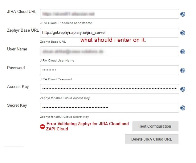

ahsanakhtar
April 27, 2017
Hi Guys,
i am doing configuration of Zephyr plugin into jekins but i don't understand from where to get Zephyr Base URL
Screenshot : zapi-configuration2.jpg
Henry
October 18, 2017
@ahsanakhtar if you click "?" beside Zephyr, it will tel you Zephyr Base URL is https://prod-api.zephyr4jiracloud.com/connect.
Good luck to you. I have not got it working :(
