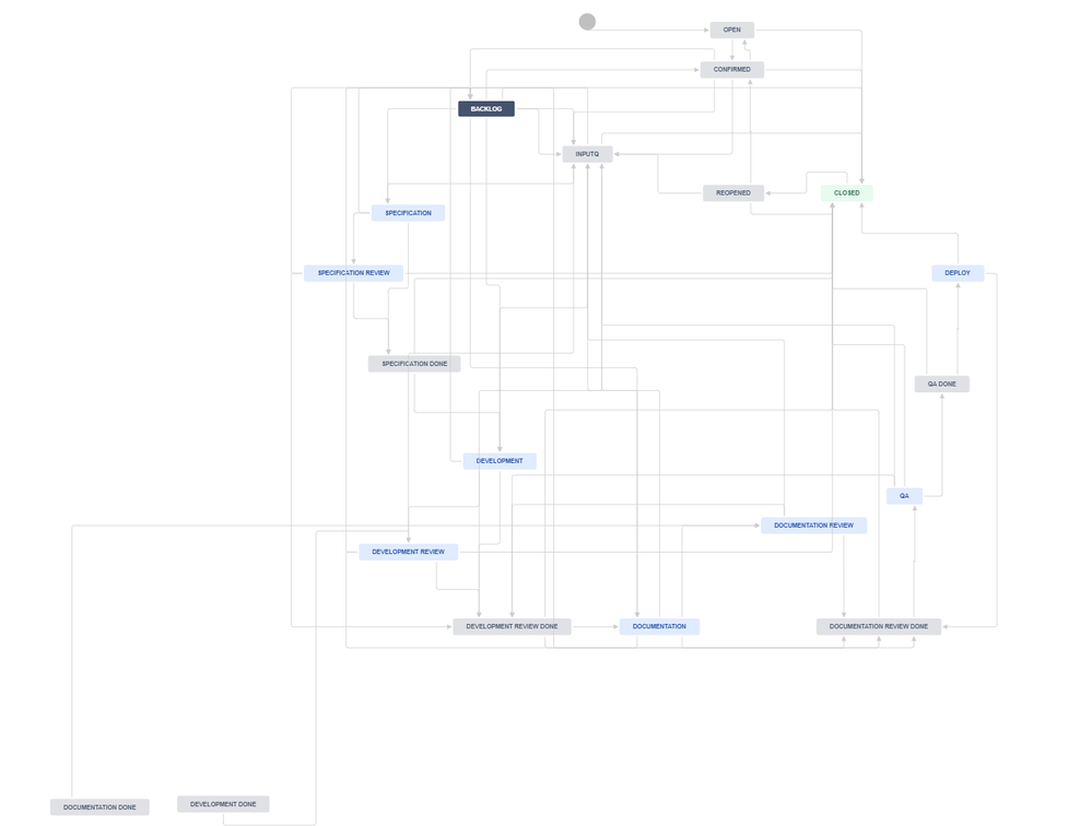

1. Attaching Workflow
2. This issue was cloned from different one
3. It has an information "No workflow transitions have been executed yet."
So I assume it was cloned when the original ticket was on BACKLOG state and because of that we are now missing possibility to do anything. Any thoughts about that?

It doesn't matter what status the issue that you cloned it from was in, the new issue will always be in the initial status.
You'll need to look at the workflow transitions out of the Backlog status and see if there are any Conditions which the new issues doesn't meet.
It's possible that some fields were cloned from the old issue and the value in those fields is preventing the transitions.
As a quick check, you could always create a new issue of the same issuetype in this project and see if you are able to transition out of the Backlog status.
