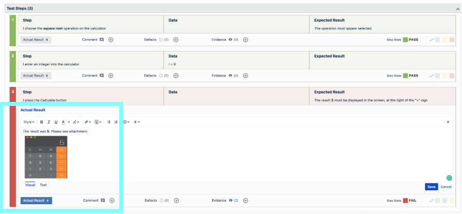

I would like to use the API or REST to pull the 'Actual Result' value from the Test Run Execution Details.   I checked the raw data from both the Test Execution page and the Test Spec page, and all I found was the step details (Step/Data/Expected Result).  I found no way of getting the Actual Result.

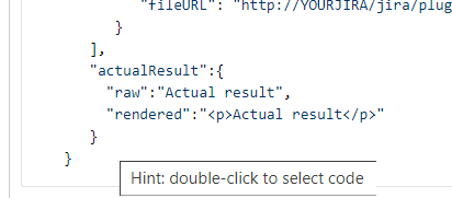

Hi @J J
You can use the Rest API to the Test Step results: https://confluence.xpand-it.com/display/public/XRAY/Test+Step+Results+-+REST
Here is an example of a result:
