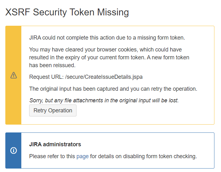

Basically, when i want to create a ticket it gives me this error:
If i clear all my tokens it doesn't work.
If i use another browser +/ incognito - doesn't work.
If i press retry it says:
The atlassian-log says:
2020-08-04 16:22:20,336 http-nio-8443-exec-8 INFO admin /secure/CreateIssueDetails.jspa [c.a.j.web.action.XsrfErrorAction] The security token is missing for 'admin'. User-Agent : 'Mozilla/5.0 (Windows NT 10.0; Win64; x64) AppleWebKit/537.36 (KHTML, like Gecko) Chrome'
Can somebody help here? How do i solve this?
After hours and hours of researching and investigation, i found the solution. I will post it here for other that might have the same problem.
<Jira-installation-directory>/conf, and edit the server.xml file.<Connector port="8080" relaxedPathChars="[]|" relaxedQueryChars="[]|{}^\`"<>" maxThreads="150" minSpareThreads="25" connectionTimeout="20000" enableLookups="false" maxHttpHeaderSize="8192" protocol="HTTP/1.1" useBodyEncodingForURI="true" redirectPort="8443" acceptCount="100" disableUploadTimeout="true" bindOnInit="false"/>This solved my problem.
The problem is in fact with tomcat wich is filtering out requests that contain special characters.
