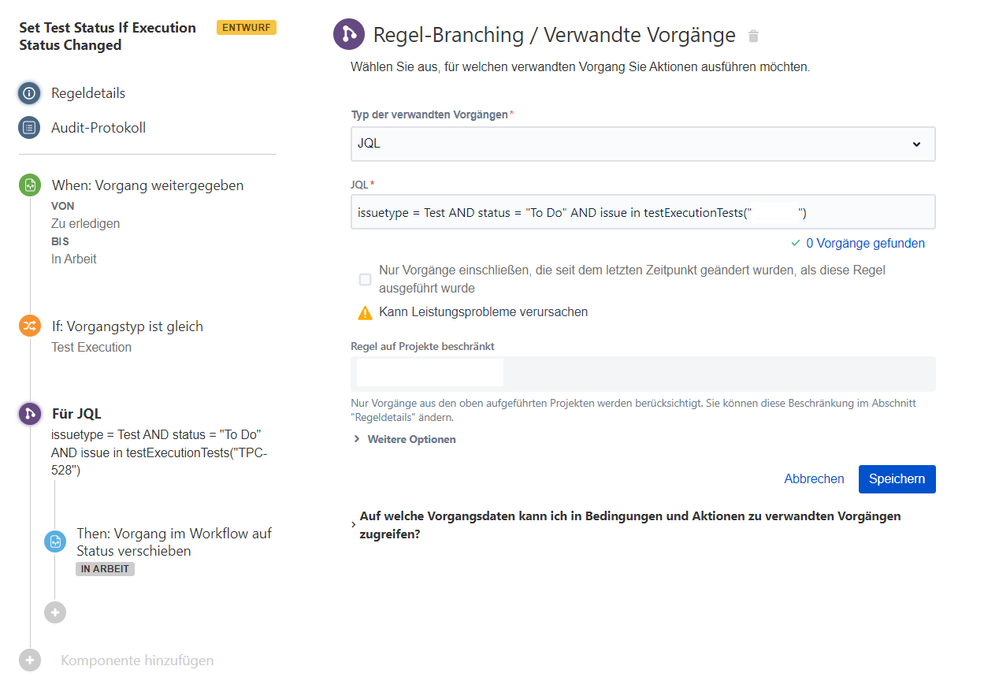

What I want: update test(s) status after execution status was changed to "In progress" from "To-do".
What's the problem: my solution in Jira Project-Automation is working only for a specific execution, but I want it to work for whole project. You can see what I build in the screenshot below.
I'm not sure if it's possible to move forward with such an approach, so I'm open to any proposals.
Would be happy for any kind of help.
P.S. Also, there is a way to change a type of processes from a JQL Rule to a Linked Rule and link all the test in the test execution, but It's not way how I want to move forward.

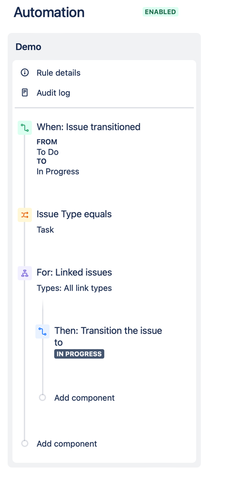

Hello, Good day. To confirm your requirement, when a Test case is moved from "To Do" to "In progress" then linked issue status need to be updated automatically ?

Please review this rule.

it's not working cause the issues are not linked in the task. As you can see in the screenshot, the issue is added only to the task, and not specifically under linked.

Maxim Borysenko
November 27, 2023
So basically my task is to set the status of the tests which are in the test execution to in progress when I change the status of the test execution. If I am going to use the way which you suggested me than I need to add all of those tests manually to my test execution under linked to make this automation works. This is not the way I want to approach with task.
