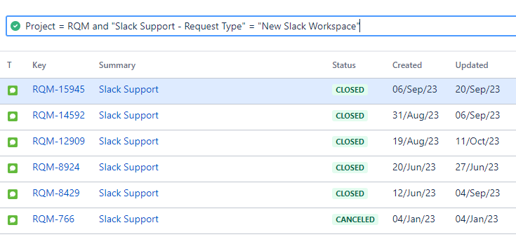

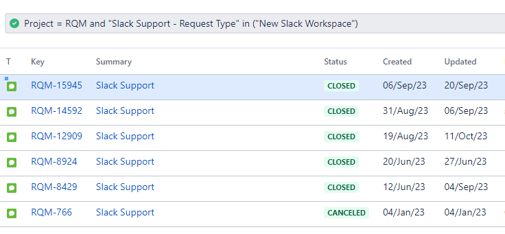

Mathew Lederman
November 1, 2023
Are you certain you have the field name correct? Below is an example of a single-select field returning the same results with "=" and "in". When using the "in" function, parentheses are required.
Note: Quotes are only truly needed when the field or option has a space such as Network Release Fixed to avoid Jira from viewing these as three separate fields. NR2 doesn't have spaces so quotes aren't required.
Are you getting any errors with "Network Release Fixed" in (NR2)? Or just no results?
Can you share a screenshot of an issue where you see "Network Release Fixed" is set to NR2?
