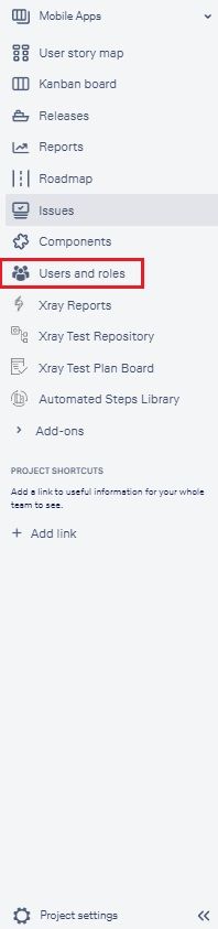

Maybe I was not precise in my question, but from my experience, the link and the content of this page Users&Roles is available to all users of one project. Updating the users is only restricted to the Administrator Role, but clicking on the link and seeing who is able to access the project is available to everyone no matter what role they are assigned to.
If I understand you right, I cannot suppress the link User&Roles, but could I restrict the display of all the users there? So users would click on the link, but not see the names or logins and their assigned roles of the other users in the project?
The Administer Projects Role is only given to the Admins of our projects, and still, all the other roles (Viewers, Reporter, Developer....) also see the users and their roles in each project. What are we doing wrong?

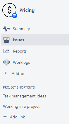

Your Business project's sidebar should look something similar to the below, with an additional button called Project Settings at the very bottom, which appears only to users that have the Administer Projects permission. Can you confirm this is the layout you see? Or is there an additional user section you're referring to?
Assuming the above is correct, it means that your Permission Scheme likely needs some fixing. Each permission can be assigned to a role or group which can in turn be assigned to users. You should review your Permission Scheme (Project Settings > Permission Scheme) and look for the row called Administer Project to see what has been assigned to it.
If this is not the case please let me know and I'll see if we can troubleshoot.

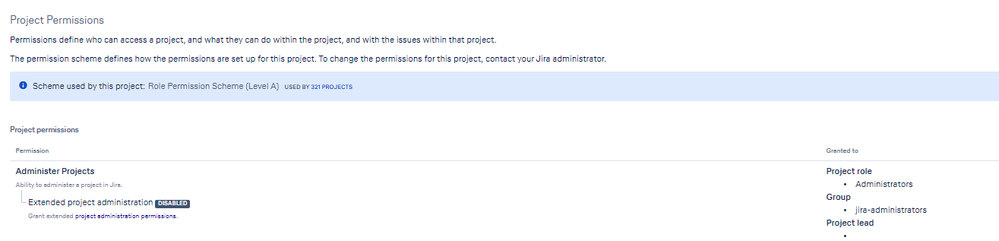

this is the sidebar in all our projects:
Since this looks quite different, does that mean it is a special setting that can be changed? All Users of JIRA see this sidebar and subsequently, when they click on the link Users&Roles they see all the users sorted by roles.
This is the permission scheme we use that only allows admins to administer the project:
That is taken from a project, is this what you were referring to?
I start to get the feeling that maybe setting this by project is not the right level to set this permission? As it seems to have no effect in our case.

Hi Susanne, thanks for the screenshot. It looks like this is present from an installed third-party plugin- are you able to confirm that your system has Jira Project Role Tab installed?
From the documentation, it looks like this is controlled by the Browse Users global permission, which provides the ability to search for/include other Jira users within issues. I don't see a good way of restricting visibility to certain users unfortunately, but you might get some further insights by reaching out to the vendor.
