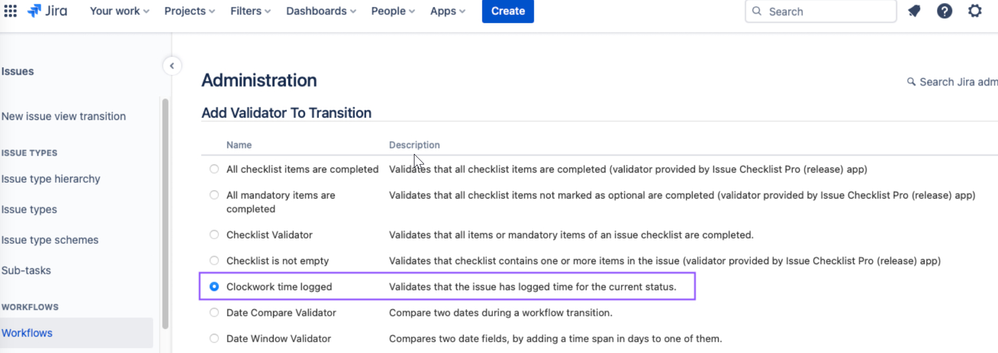

Adaeze_Jude_HEROCODERS
May 9, 2024
Hi @Aswathi D
You can use Clockwork to make sure that users log work on a particular status before transitioning this issue to a Done status using the Clockwork in-built validator, as below:
To set this up, you need to enable the Time is logged validation in project settings > Clockwork
Then navigate to the Workflow and click on the Done transition to add a Validator.
Add the above Validator and then publish the draft.
This validator will ensure that time is logged on the Current status before the issue can be transitioned to DONE.
Let me know if this is something you would like to explore and we can help you set this up. Please reach out here.
