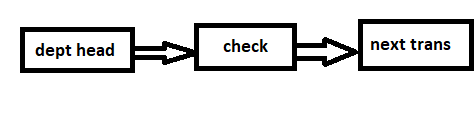

So basically from ....->Dept Head -> Check  after approving it should go to the Check transition right.

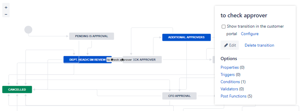

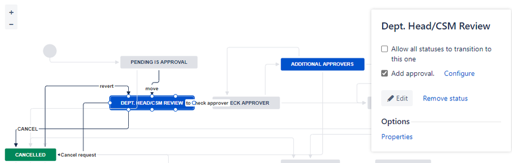

and this is the workflow
Alex Koxaras -Relational-
September 13, 2021
Thank you for pasting all the info @ginxx009 .

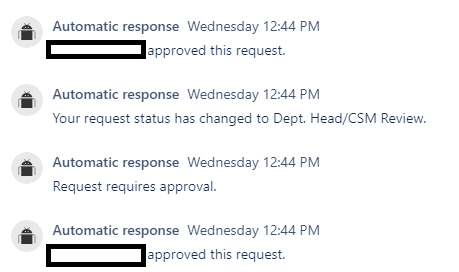

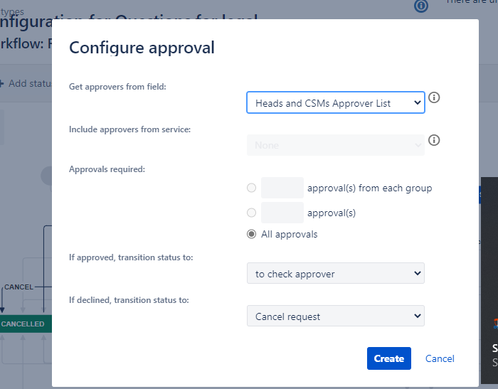

From the history you pasted, it seems that this issue was approved at least two times, correct? Can you click on the "Dept Head" status and paste us the approval configuration please?
ginxx009
September 13, 2021
It was approved twice because I have 2 approvals before going to the Check transition
the Pending IS Approval is also have an approval that's why it's two approval on the history.

First of, and just to get it out of the way, you most likely the 2nd "cancel" transition from your "dept head" status to cancel status, is obsolete. I would recommend to remove it. It only adds confusion. Once cancel is enough :)
