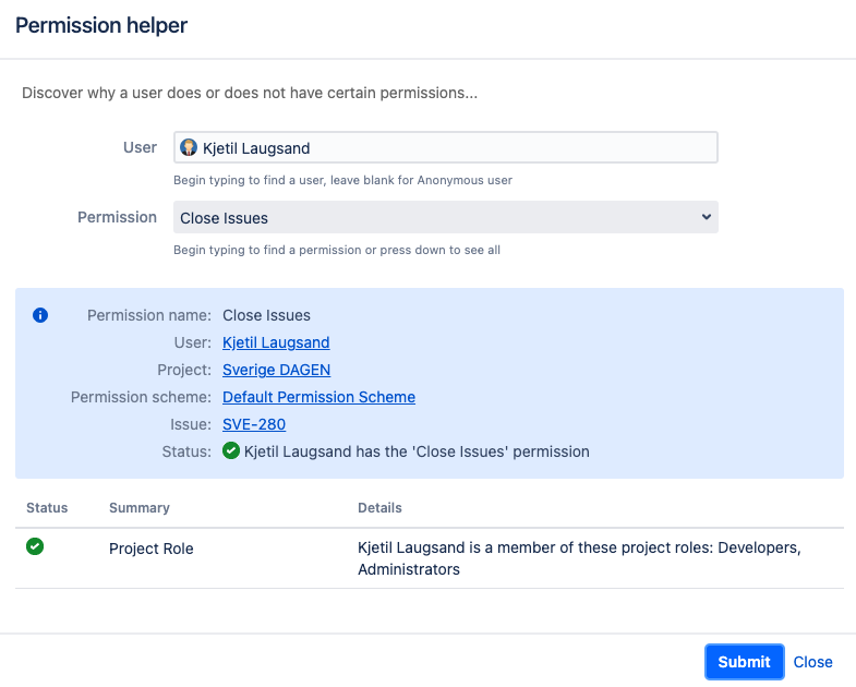

I don't believe it is a issue with permissions. I have checked with the permission helper, and it shows that I have the nescessary permissions.

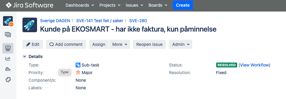

Image of the view issue screen. I presumed that the 'Closed' button should be visible here.

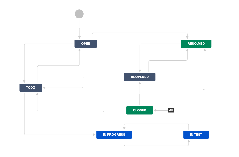

Image of the workflow associated with the project and issue type. As you can see all states may transition to Closed state.

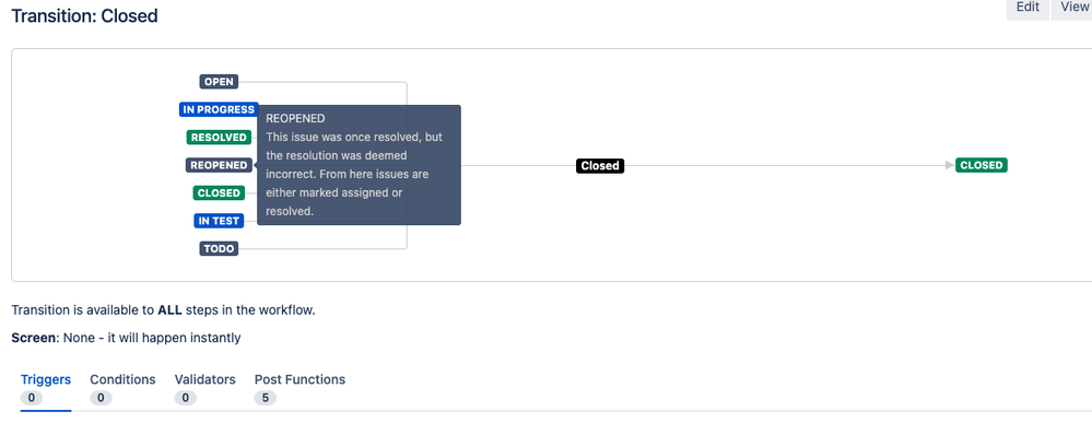

And finally an image of the Closed transition. No conditions or validators are configured.

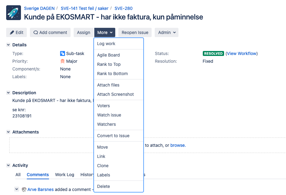

I can't recall the behavior of Server ...what shows under the More drop down?

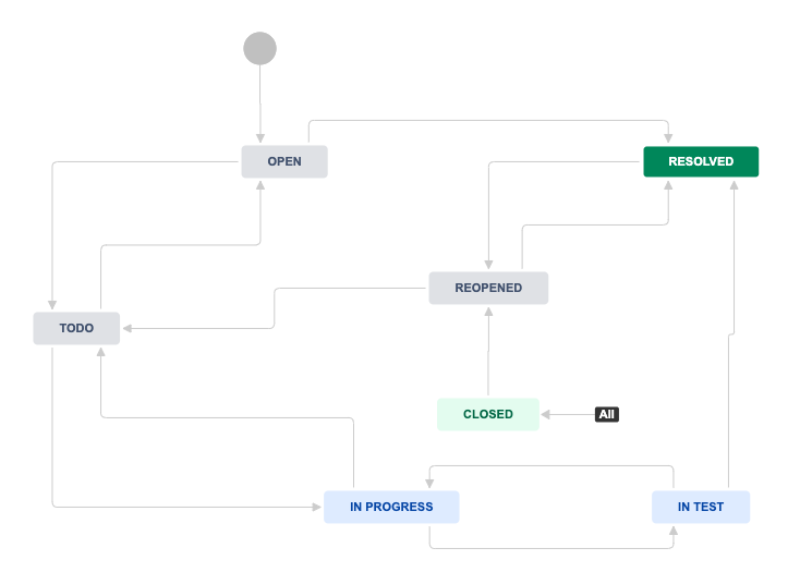

Below is a screenshot of the workflow that is in use:
