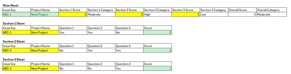

I want to see if I can get some feedback from the community regarding a process that I’m looking to implement. We have done something similar with a different platform but are looking to see if this is possible in the Atlassian ecosystem. I’ve created a simplified set of tables to help visualize the process:
For context, the green coded cells are the sources of a data point, the yellow cells are inherited from the data source and anything in white just stays within the sheet. Each project in the main sheet requires a score from sections 1-3 in order to generate an overall score and category for the project. The steps are as follows:
  1. A new submission for a project adds an entry to the ‘Main Sheet’ that will include the project name and key, while the remaining data points are blank.
  2. Each section sheet will then have an entry added that inherits the key and project name from the main sheet (Not certain if the key has to be unique across the sheets). The questions for the section entries will initially be blank.
  3. Email forms are sent to retrieve the responses for the section entries.
  4. Once all section questions have been answered, a score is calculated based on the responses (e.g., - Yes = 2, No = 1, N/A = 0).
  5. Once a score is available for the section entry, the value is added to the corresponding section score column in the main sheet.
  6. The categories for each section in the main sheet are derived from the corresponding score (e.g. score of 2 is assigned moderate)
  7. Once all scores are available, then the overall score in the main sheet is generated based on the average of the section scores.
  8. The overall category is determined based on where the average score falls in a range (e.g. Less than 1 equals low, between 1 and 2 equals moderate, greater than 3 equals high).

Hi Michael,
The Scripted Fields feature of ScriptRunner for Jira Cloud could be used to achieve fields which do calculations of other fields on an issue.
This may be something you could use if you had different fields on an issue to match each cell in the sheet and then to calculate values based on the values of different fields.

Generally speaking, you can implement calculations with the Jira automation rules that are available out of the box. There are many many examples for that on this site.
The common pattern is e.g., that field A and B affect the value of field C. Let's say all these are number type custom fields and the formula is C = 2*A+B.
You can implement an automation that gets the values of A and B, calculates the formula and updates the value of C. Then you trigger this rule when either A or B are updated.
