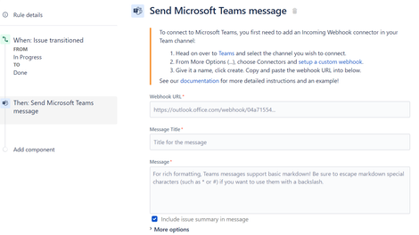

If you can't find a resolution to your problem, you could always set up an automation rule instead of a post function to achieve this. There is an out of the box "Send Microsoft Teams" message" action, where you can enter your webhook, and can customise the message title and body
Callum Carlile _Automation Consultants_
September 22, 2020
@Shalaka Wadekar For some reason my second paragraph above combined itself with the image posted so got removed from the post, so apologies for that random out of context image!
I have amended the post to explain what the image is about :)
