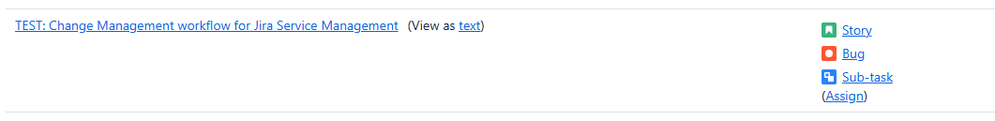

If the workflow is included in the workflow scheme and the scheme is attached to the project it should become active when the issue types are assigned to it. It should not require a restart. image.png

yeah this should be the case, but it isn't.. the workflow is assigned and works, but it is marked as inactive, too at the same time..
So when I go to project settings -> workflows and then press the edit pencil i'm redirected to the global admin interface and only in this interface it says "inactive" "used in 1 project", also in the global administration it's at the bottom in the inactive tab, but it's added to a workflow scheme and this scheme is added to a project, but only a restart fixes this...
