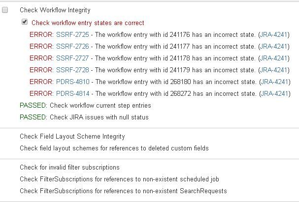

Leena Bakshi
September 7, 2017
Integrity checker showed errors in the workflow entry state. for issues in two different projects instead of one.Integrity checker result.JPG
Please see the screenshot. so all I did was clicked on Fix and it did FIX !! :)

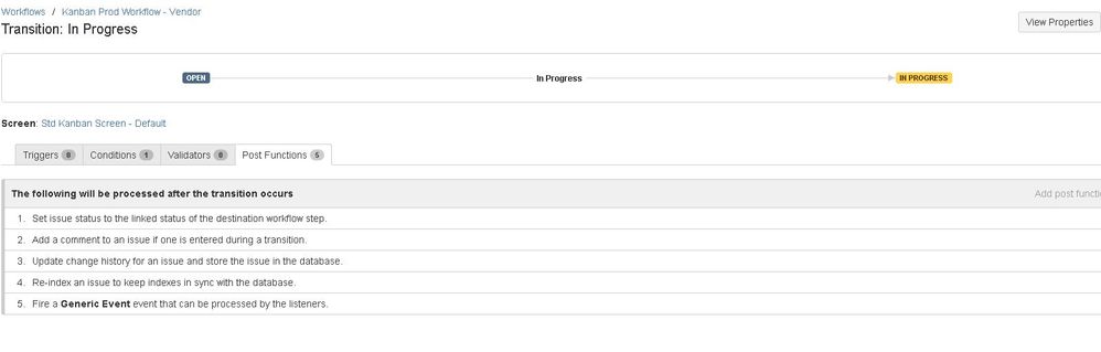

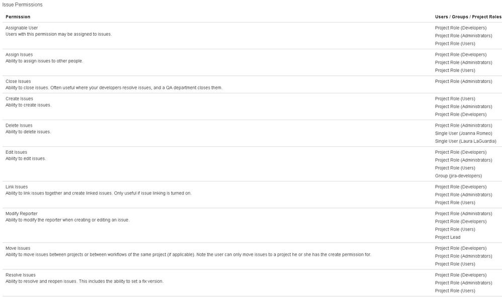

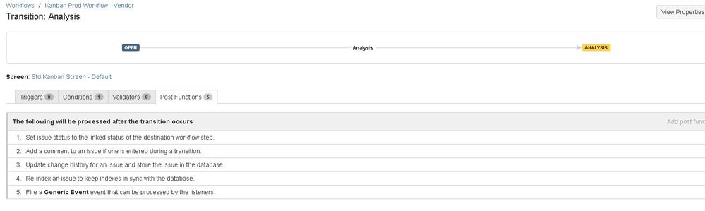

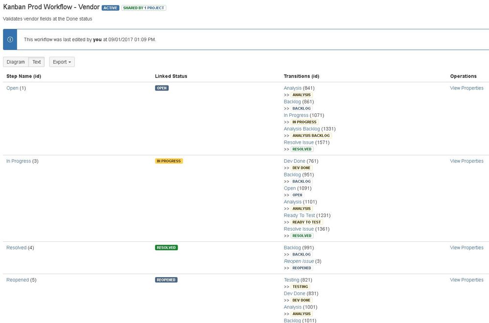

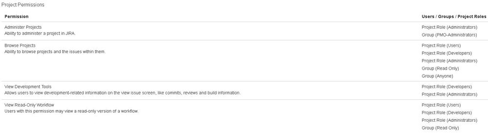

Leena Bakshi
September 6, 2017
Hi Thomas,
Thank you for your help in this matter. I really appreaciate it.
Please find the screen shots attached of the permission scheme and workflow and their conditions and post function.
We have the same condition amd post function for all the transitions in this workflow.
