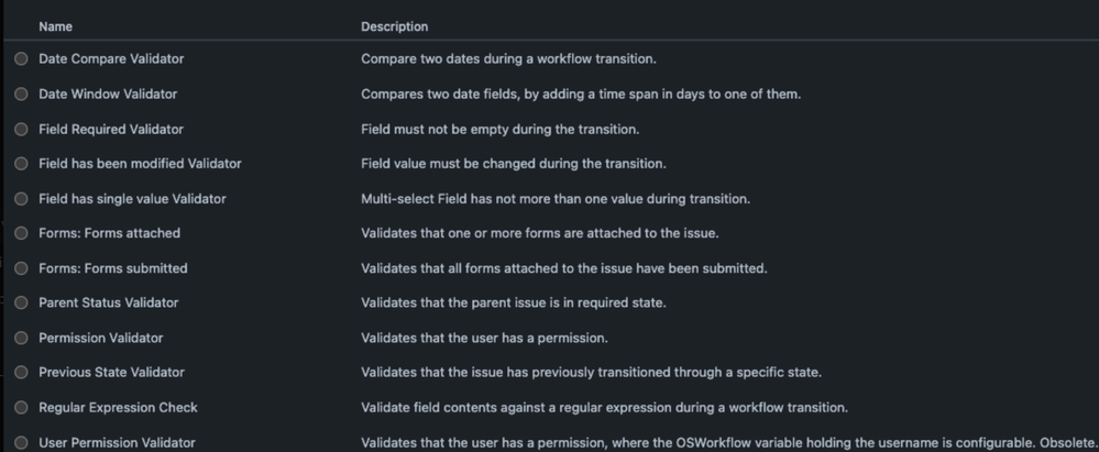

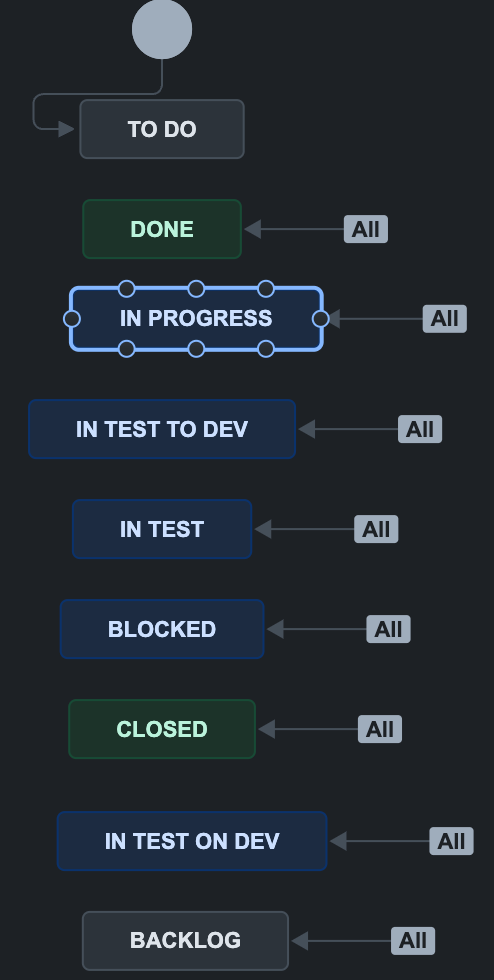

Hi, Is it possible to block the transition to status after a change from it? Maybe add a validator? For example, once you change from "in progress" to any status (review, testing, etc.), you can't go back to the status in progress.
Ignore IN TEST TO DEV, IN TEST ON DEV, BLOCKED AND CLOSED

Mikael Sandberg
July 15, 2024
Yes, that is possible. You can either use the previous status validator, or the other option is to disable the global transition and instead create a transition from for example To Do to In Progress.

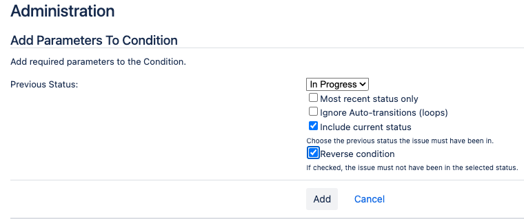

Mikael Sandberg
July 15, 2024
I should have said the condition in my answer. The previous status condition will evaluate if the issue has been in a previous status or not, but you invert it so that you can prevent the issue going back to that status
Here is an issue that is using the above condition, it is currently in the In progress status and I have these options:
If I move it to To Do, my only option from there is Done
And this is persistent so it doesn't matter how many times I move it between To Do and Done, In progress will not be an option since I have already been in that status. The scenario you describe would only happen if you selected "Most recent status only".
