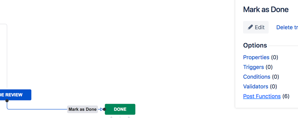

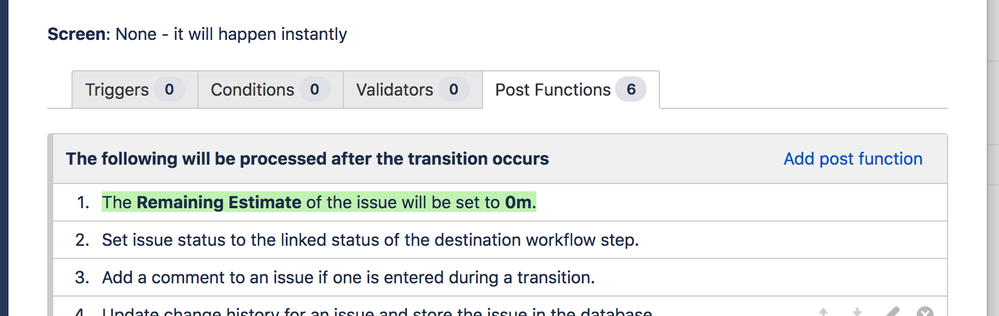

however you can help yourself @Tobias by adding a POST function in the workflow to automatically update the field when somebody closes the issue.
the only difference: validators would require people to change the remaining estimate manually befor moving an issue and the post function does it for them in case they don't do it
