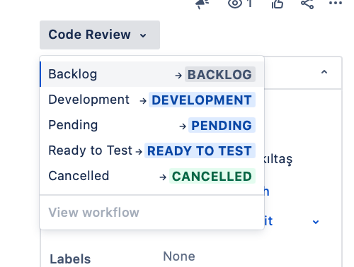

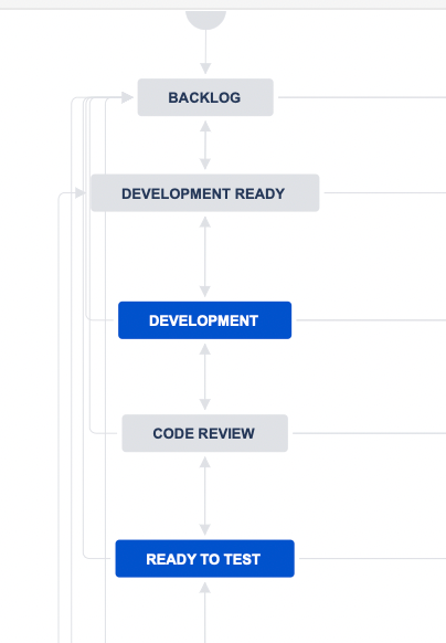

I created a Workflow schema.
I have a question:
When you get the status "Code Review", the next status should be "Ready to Test", but the statuses are not sequential in the task.
Screenshots are attached.
Is this normal? Or is there a transition order?
How are the statuses ordered? By color? Not in alphabetical order?
