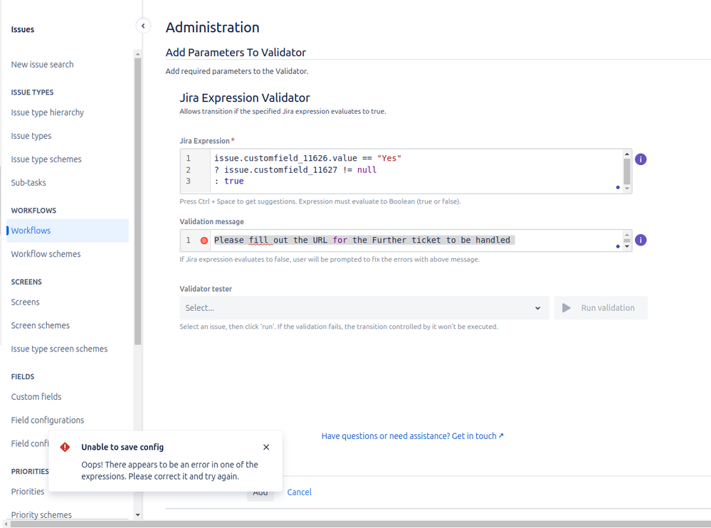

Thank you for your help. I have tried this solution but there is a mistake in the Jira expression. See the screenshot below
Maciej Dudziak _Forgappify_
Atlassian Partner
July 15, 2024
Validation message must be a string, please surround it with ""
Yves MOUAFO
July 16, 2024
OK thank you, it works now!

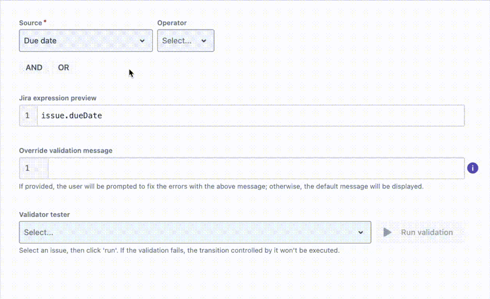

Hope you're doing well! Our journey to simplifying Jira Expressions has brought us to the 'Ultimate Validator' (now in Beta). It lets you tap into most of the power of Jira Expressions—without writing a single line of code—through a simple UI. Just wanted to share this with you—hope you find it useful! Here’s how your case of a conditionally required field looks in the UI
