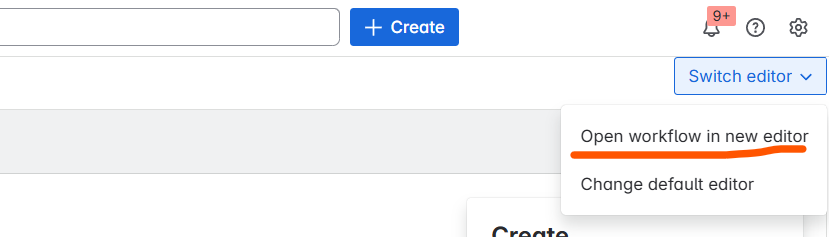

Keerthy Mamidi
April 16, 2025
Hi @Jean-Paul Ruiz You can try using the new workflow editor from here when you open it for editing. I was facing the same error from the old editor but I was successful using the new one.
