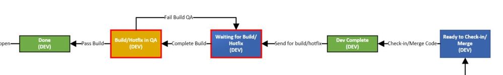

Thank you @Nic Brough -Adaptavist- , so the Ready to Deploy (in our case it's called "Dev Complete") status would be in the green (done) category and the next steps would be either in a in-progress or to-do category? Or just leave the "Dev Complete" status in a to-do category and remove anything after this status from the board? Also, I'm creating this workflow in visio so for our purposes the workflow goes from right to left.Capture.JPG
October 14, 2020
It doesn't matter what the category is.  If you do not map a status on to the board, issues in that status will not appear on it.
Your diagram suggests to me that you should un-map the three status to the left on the developer's board, their done is "dev complete"
