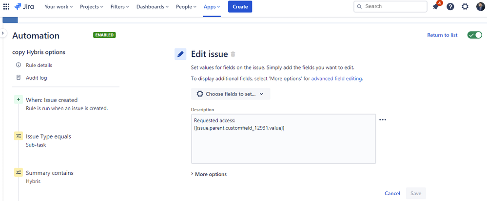

for the context:
One onboarding request needs to be executed by multiple people
I have set up a set of rules to create sub-tasks and assign them to different people.
I need to copy some information from the parent request to a child sub-task
I know many people struggled with this. I've seen their community posts. For some re-fetch prior to issue creation worked, but not for me.
I have set up an extra rule to trigger upon an Issue Created event, to check if issue is a sub-task and has a keyword in the summary. But it does not ever trigger.
When I set it to trigger manually and run it manually from Issue view it runs and does what I need: it copies a check boxes values from the parent's custom field to the child's description perfectly
Requested access:
{{issue.parent.customfield_12931.value}}
This is very frustrating. How do I get this to work?
Any help is much appreciated
Alexey Paveliev
May 25, 2021
This needs to be checked in the second rule to trigger:
[ ] Check to allow other rule actions to trigger this rule. Only enable this if you need this rule to execute in response to another rule.
But this is still a workaround. I wish I didn't have to create this rule altogether

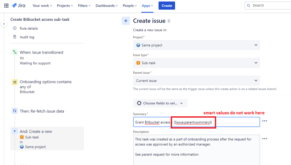

Alexey Paveliev
May 26, 2021
@Simmo
It's an IT Support project in Support Management
This a screenshot of the rule where I create a subtask when main request gets approved.
My intention was to have some of the initial request's information to be present in the sub-task
This is not exactly the custom field but still does not work regardless.
I searched and found some posts here about the same issue. One user reported they had success with re-fetch action prior to creation. I tried but to no avail. The summary in the example above lacks the smart value.
Here is an additional rule I created to transfer some of the Parent's SF data to the child which worked just fine. It is hooked up to create issue event
Simmo
May 26, 2021
Hi @Alexey Paveliev
Ah, I see your issue in the first screenshot. So, the smart value you should be using is just:
{{issue.summary}}
The reason for this is that issue refers to whatever issue is in context. In your case, you haven't used a branch at all and your trigger is issue transitioned so that is the issue in context. The sub task hasn't been created yet so you don't need to use .parent yet.
Hopefully that should resolve your issue and you shouldn't need that second rule then?
Cheers,
Simeon.
