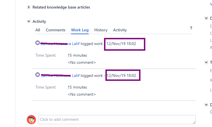

When service-desk agent wants do log work it duplicates:
Please help me to solve this problem.

Hi Jamil,
I see that you appear to have duplicate work log entries here.  I have not yet seen this problem before, and I can't seem to find any other reports of this.  However I'd like to try to learn more about your environment here.
  • Are the worklogs in this case being entered from the More -> Log work menu?  Or are the agents adding their time during an transition screen for example instead?  Or is there some other way that work is being logged on these issues?
  • What version of Jira Service Desk is this?
  • Are you using any other kind of time tracking plugins with this Jira server site, such as tempo or others?
I tried to recreate this problem in my own Jira Service Desk, but so far I have not been able to.  Perhaps if we can learn more about your environment here I can better help guide you to a solution.

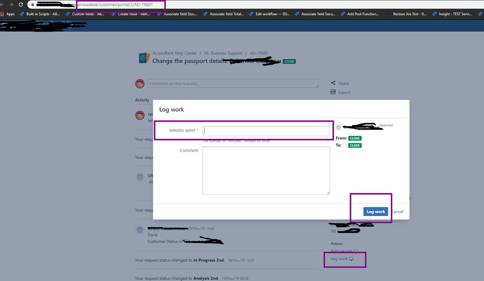

Jamil Rahimov
December 12, 2019
We have log work transition on customer portal:
Agents do log work using screen:

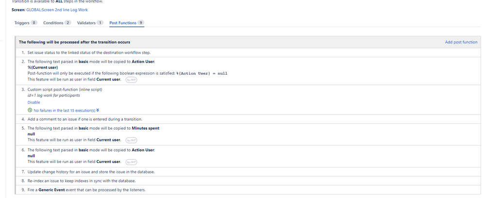

I'm having some difficulties trying to replicate this problem.  Could we take a closer look at the workflow being used for this step?  I'd be interested to see what steps it might have for the post-functions here.
Also are you using any sort of plugins for Service Desk here?  In my setup, the customer portal doesn't quite have all the same options I can see in yours, so I'd be interested to better understand why there is a difference between the available options here.
Jamil Rahimov
December 16, 2019
@Andy Heinzer
Post-functions:
Post-functions.PNG//---------------------------------------------------------------------------------------------

As you can see from the post-functions image there used JWT plugin and the script.
Andy Heinzer
December 19, 2019
I'm afraid I'm not very familiar with using the JWT plugin or this script itself.  Could you let me know more about this?  I suspect that step 3 in postfunctions it what is responsible for converting the minutes input into a worklog entry.  This script is being run via the scriptrunner plugin, right?
I'm not sure I understand what steps 2,5,6 are actually doing here.  I can read what they say, but since I'm not familiar with the use of the JWT plugin, it's unclear to me what steps they might be taking in addition to that script itself which looks like groovy code.
I suspect that the action to log work is somehow getting called twice within the same thread, but having reviewed the script there, it is not clear to me yet why that might be.  I'd be interested to see if it's possible to remove the other JWT post functions there to see if the log work still functions.  If not, then perhaps changing the order here might prove beneficial as sometimes the order in which a post-function appears in the workflow can have significant effects on its behavior.
Thorsten Letschert _Decadis AG_
January 7, 2020
Hi @Jamil Rahimov , @Andy Heinzer ,
from what I see, post function #2 is used to set a 'helper field' 'Action User' with the current user if no dedicated action user is present.
Post functions #5 and #6 are used to clear the 'Action user' as well as the 'Minutes spent' afterwards.
All of the aforementioned post functions should have no effect on the actual work logging. That said, duplicate entries must come either from a duplicate creation within the script itself, or a duplicate execution of this transition. The second option could be excluded if comments that are entered appear only once.
