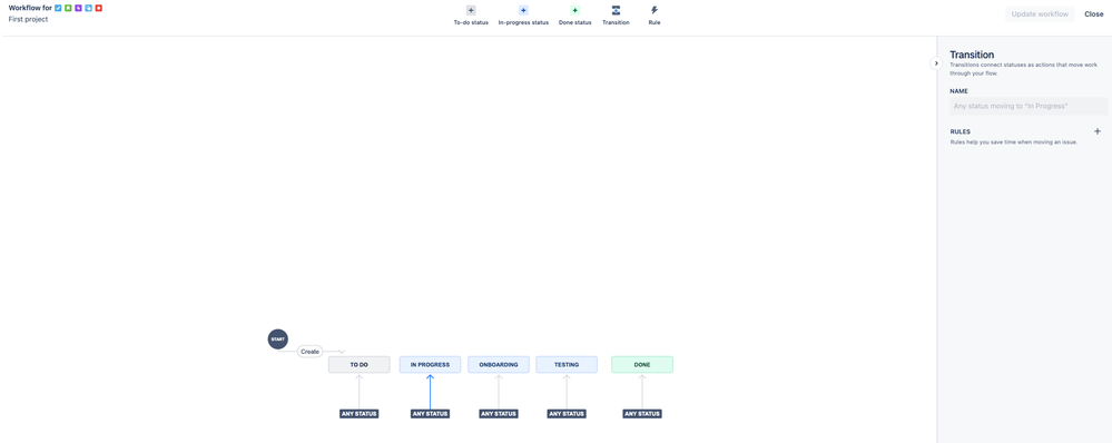

Sorry, haven't noticed you are working on a Team-managed project. In this case the flow will be slightly different:
1. Click on the three dots in the right upper corner on the board
2. Select Manage workflow
3. Click on the transition that needs to be updated

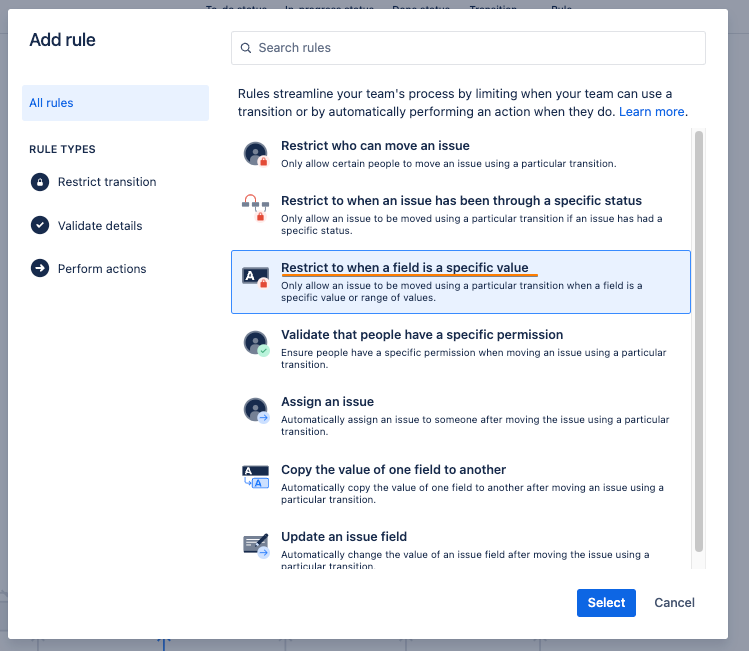

4. Click on the "+" for the Rules on the right side

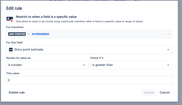

5. Select the following from the Rule list: Restrict to when the field is a specific value
6. Select the field you need and configure the remaining values
7. Click Save

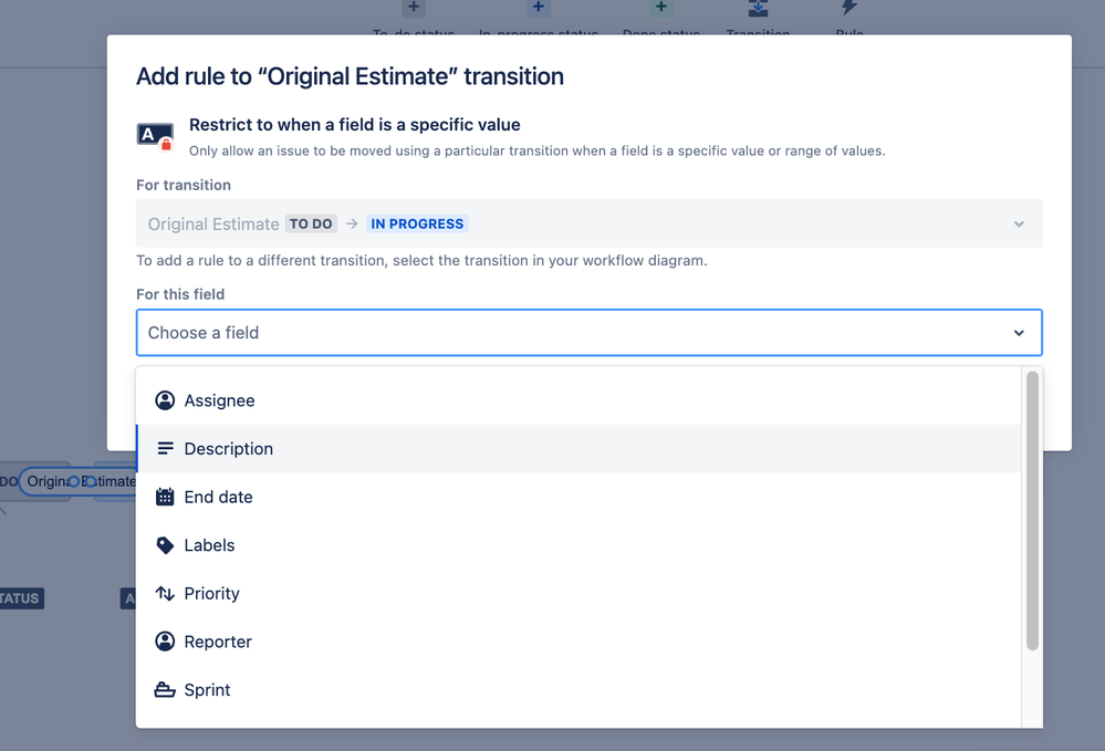

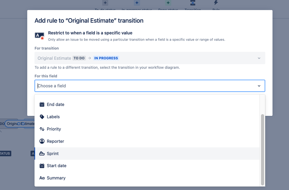

I don't have the option to select the field for Original Estimate. You can see below the available fields for me. Can you please advise on what is the reason for this?

You can use the "Restrict (transition) to when a field has a specific value", as suggested by @Oleksandr Siryi_Railsware_ , for checking that the Original Estimate field is not empty.

I apologize. I spoke without first validating my suggestion.
It does appear that neither the Original Estimate nor the Time Spent field is available for selection in that workflow transition rule in Team Managed projects.
