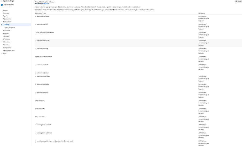

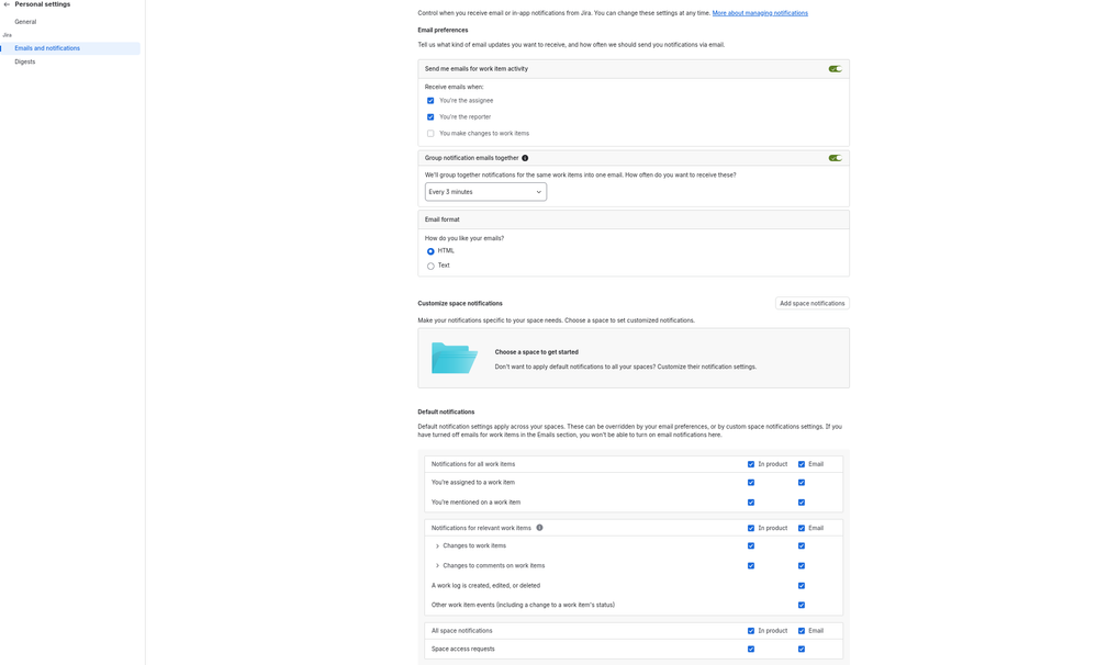

I already checked the notification settings of the assignee in profile settings which are all active. Also i checked notification settings in space. All include the "Current Assignee"

Also, can you try enabling the notification for "You make changes to work items" to see if, potentially, notifications will land then? 👀

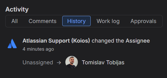

@griesi007 interesting...
In the history, this should be logged as "User A changed the Assignee"; see below

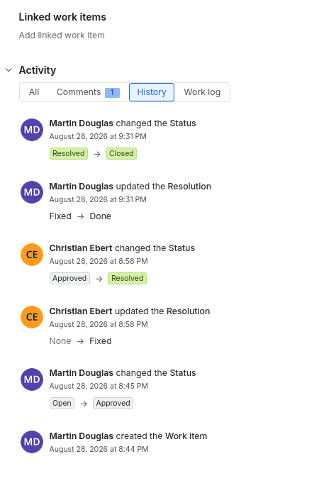

griesi007
August 29, 2026
@Tomislav Tobijas interestingly i do never see an "asssignment" in history. my account (=assignee) is jira admin. Probably only assignee change is logged but not the initial manual assignment? No other user i can test with

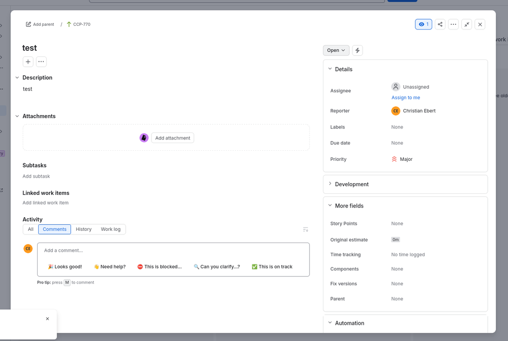

griesi007
August 29, 2026
@James Gamble There is no assign action in my UI
James Gamble
August 29, 2026
Looking at your screenshot, you’re already in the right place. In the current Jira Cloud UI, the assignment is made directly through the Assignee field in Details rather than through a separate Assign action.
For the next test, I’d create a fresh work item and leave it Unassigned at creation. After the work item exists, set:
Details > Assignee > your account
Then check Activity > History immediately afterward.
You can also run:
key = YOUR-KEY AND assignee CHANGED
If the initial Unassigned > User assignment doesn’t appear in History and the work item doesn’t match that JQL, try changing the Assignee once more afterward, such as back to Unassigned.
If that second change is recorded but the initial assignment isn’t, that would narrow this down specifically to the first post-creation assignment.

I’d go back to the notification configuration and specifically verify that Current Assignee is included under Work item created, not just Work item assigned.
Atlassian documents those as separate notification events, and the Current Assignee can be configured as a recipient.
